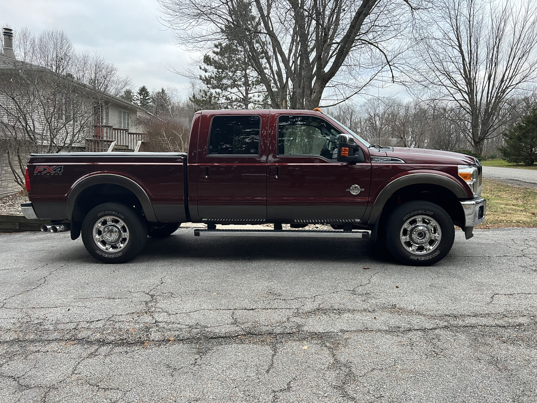

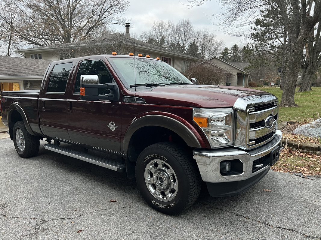

We bought it! It is currently at the Ford dealer for a recall and synch update. As well as an oil and fuel filter changes. It doesn’t fit in the garage so I need to make sure we get the paint properly protected. The dog is afraid of it. This is way more advance than my 01’ 7.3.

What is a disaster prevention kit? Is there a proactive way to replace the Bosch pump? Here’s the truck.

Good looking truck, looks like a Cowboy Cadillac.
