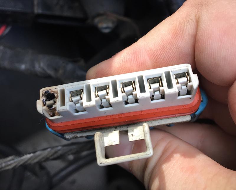

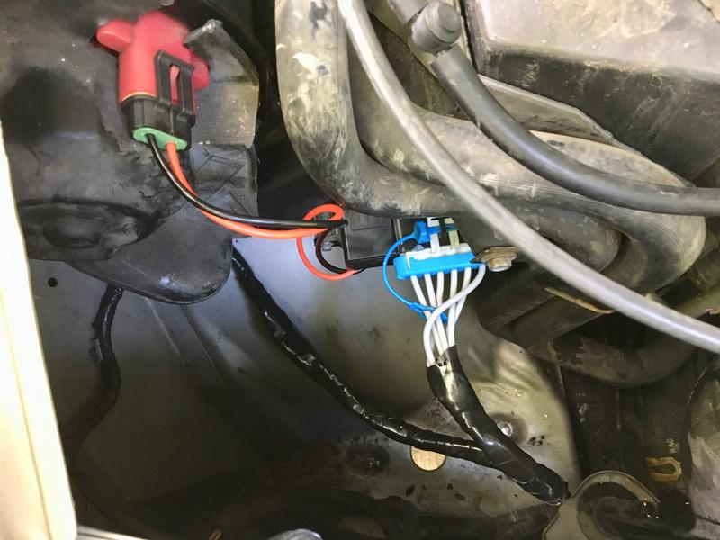

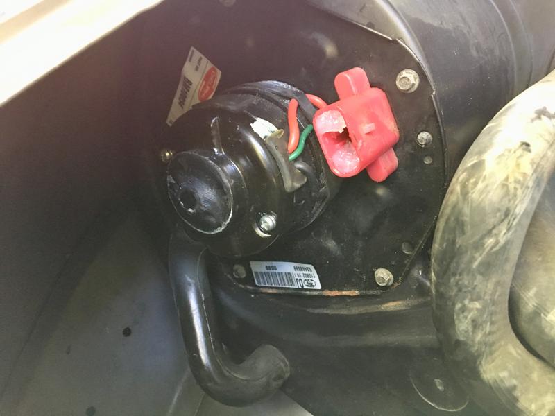

Blower motors, resistors and wiring can be rather problematic. The blower motors are brush motors and sometimes they can be cleaned out to live a little longer. The wiring to the resistor apparently isn't quite the right size and the high speed pin will burn up pretty good, then the other speeds will surely follow. The resistor's original design wasn't so great and could take out both the wiring and the blower motor; the replacement design is a pretty good upgrade. All of this is on the passenger side, including the vacuum lines, check valve, line to the heater control valve and vacuum reservoir, line that crosses over the motor to the driver's side head.
All of that is easy to get to. Pull up the radiator overflow and washer reservoir, disconnect the pump harness and twist it out of the way, keeping the washer and radiator hoses attached.

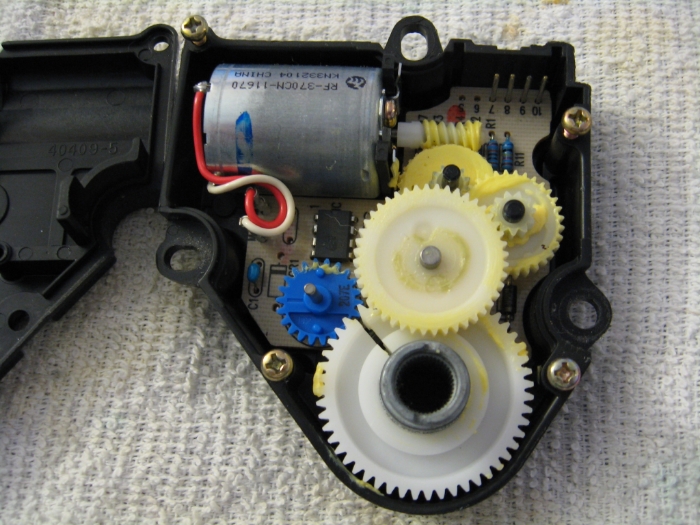

Inside, you've got a vacuum pot just behind the bottom right of the passenger side knee bolster. All other vacuum lines are behind the doghouse and the heater controls. The blend door actuator is under the doghouse, against the driver's side of the blower motor housing (black actuator on black plastic, so use a light). There are 5 plastic gears inside that can crack and jam.
If you pull the blower motor out, there could be a rat's nest of crap in the housing. There is a filter on the other side of the evaporator housing from the blower motor, but I've never had to clean or replace it.
Oh, and the blend door actuator guts:
