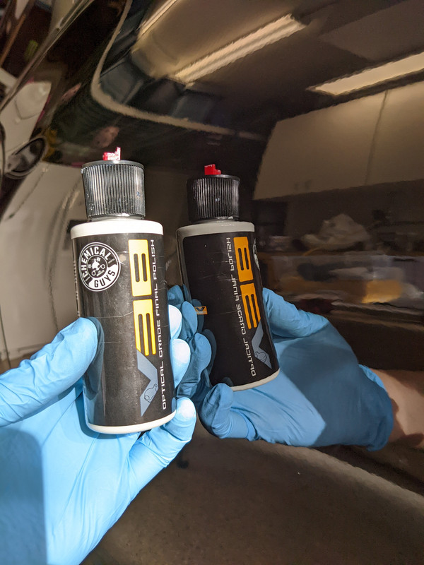

Anyway, now that it's "my" car, it needed a little TLC. Started off with a wash, then claybar, then a 4 stage polish on the hood (2 stage on the sides), wipe down with IPA solution, then ceramic coat with Adam's Graphene Ceramic. I restored the headlights and plastic trim with Cerakote.

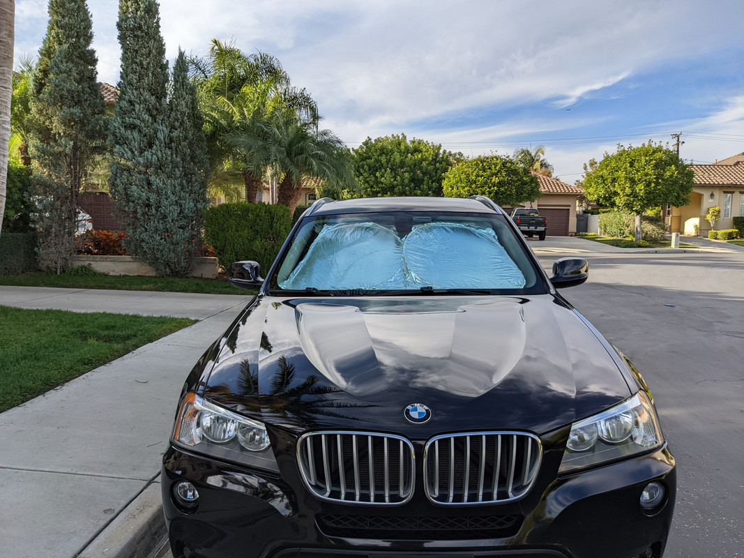

There are dings and dents, but all in all, the car looks really good for my first attempt at ceramic and paint correction (I think). Was hoping to get some practice in before I worked on my own car and my wife's new car, and this served that purpose well.

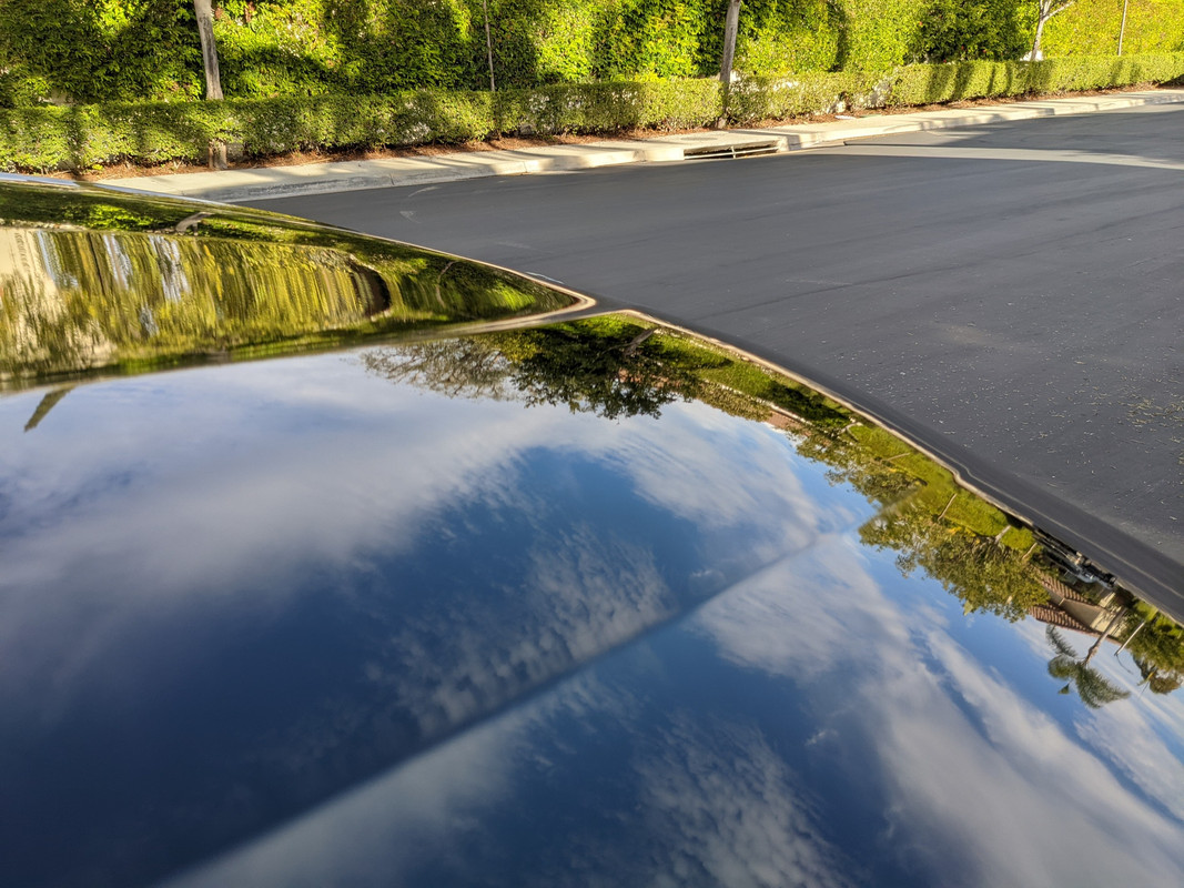

MANY hours of machine polishing later.
