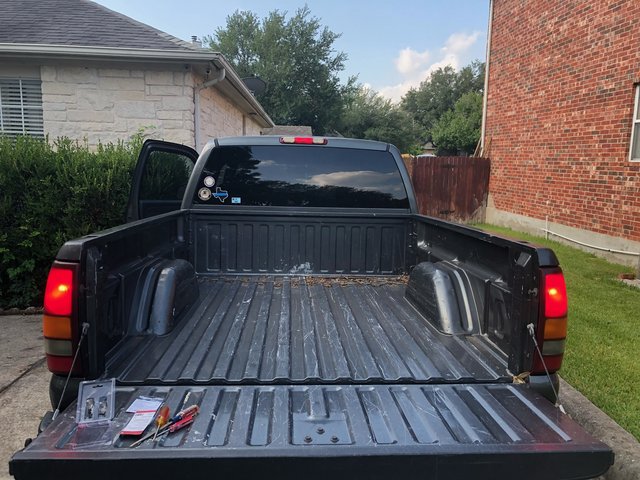

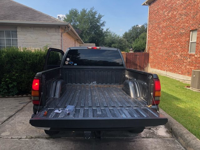

I installed my brake bulbs today. I am pretty happy with them.
Here I had replaced just the left brake light to see the difference.
Here is a picture of both brake lights and the third brake light replaced.

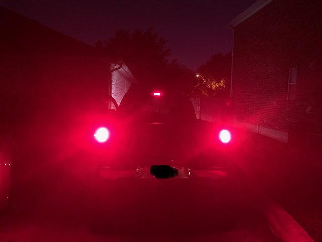

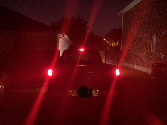

Nighttime picture before replacement.
Nighttime picture after replacement.

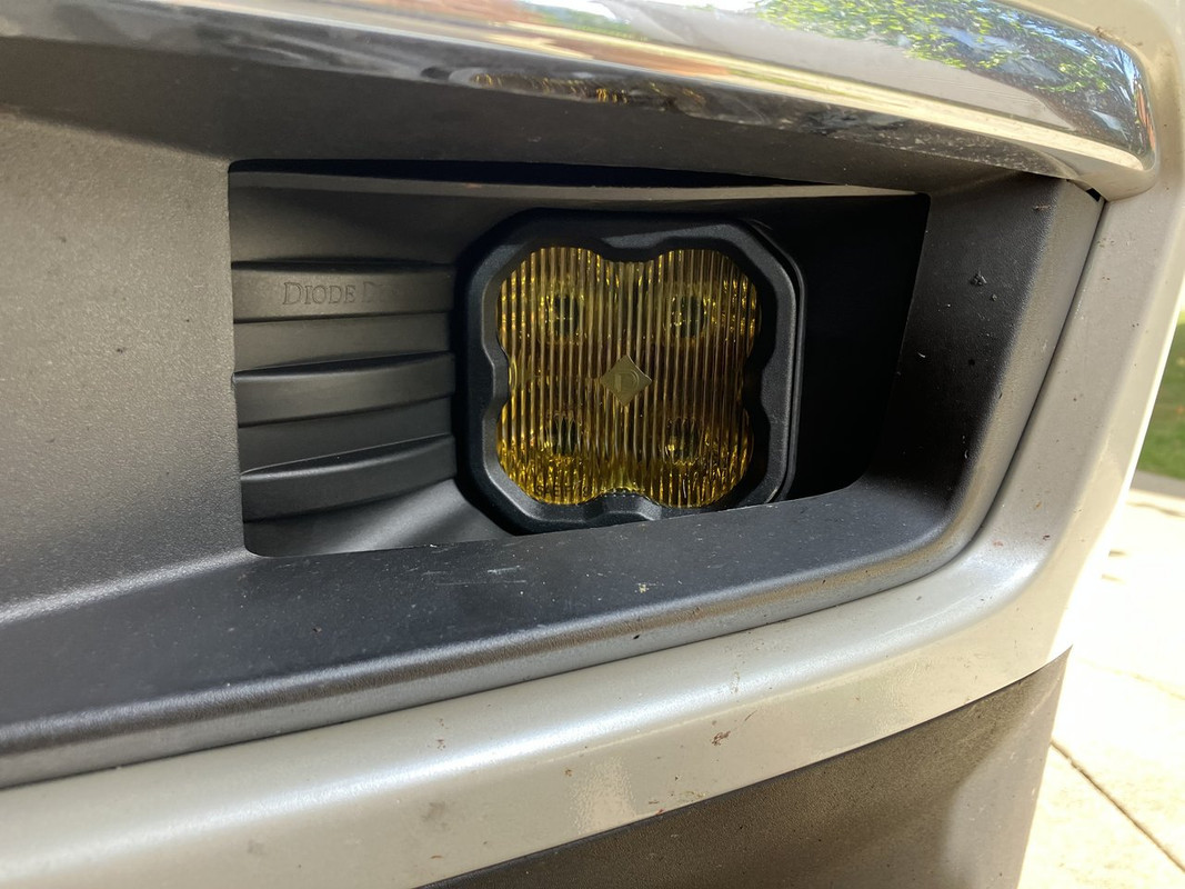

Got them installed today. Looking forward to nightfall to check them out.
Be interested to see if they are as helpful as they are on my Tundra.
The Fog lights on my Tundra are about 6” higher than the Suburban. I am also fairly disappointed in the fit of these compared to the Tundra. There are zero gaps around the bezel and none of the light is blocked.
On these however there is a pretty large gap between the top of the bezel and the bumper opening.
Part of the problem I believe is that you removed the factory housing from the mount and attach the OEM mount to the DD bezel. The OEM light attaches to the mount with 3 screws. 2 at the top and 1 at the bottom but the DD only uses the lower screw and had alignment tabs that go through the upper two holes where OEM screws go. They don’t lock in at all so the only actual connection for the bezel to the mount is the lone screw at the bottom that attaches to a plastic pop clip. You have to crank the bottom screw down so tight for the light and bezel to be secure it forces that top portion down giving you the gap. This is not an off-road rig but I certainly would expect for the light and bezel to break and become separated with any moderate off road use.
I did not have a chance today but am going to try to use some zip ties to help attach it to the OEM mount and hopefully not only make the light more secure but get rid of the gap at the top.
Also the light itself sits almost a quarter inch below the opening in the bumper so I am sure I am loosing a touch of the full light pattern.
