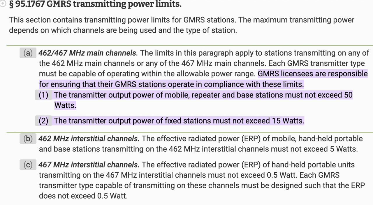

Isn't GMRS limited to 5W?
Posts: 23108 | Location: Montana | Registered: November 01, 2010Reply With QuoteReport This Post
No, 50 watts is the max. But GMRS HTs are pretty much in the 5-6 watt range because of battery power
Picture of SigSentry
Most GMRS HTs are 5 Watters. Tx is limited to 50 Watts (e.g. mobiles and repeaters). But even 50 Watts in the real world will be a little less. However, more Watts is a diminishing return to punch through obstacles. If your location is fixed then the antenna will be the best investment.
Posts: 4000 | Registered: May 30, 2011Reply With QuoteReport This Post
Seems a tad more complicated than that.
Why these limits on GMRS? Is it that UHF isn't effective for long-distance transmissions because the radio waves do not skip off of the ionosphere?
Or is it more a matter of avoiding overloading GMRS radios receiving transmitted signals?
Posts: 114901 | Registered: January 20, 2000Reply With QuoteReport This Post
