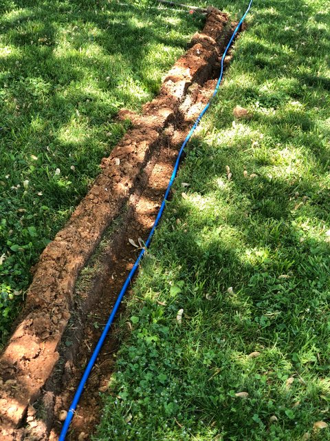

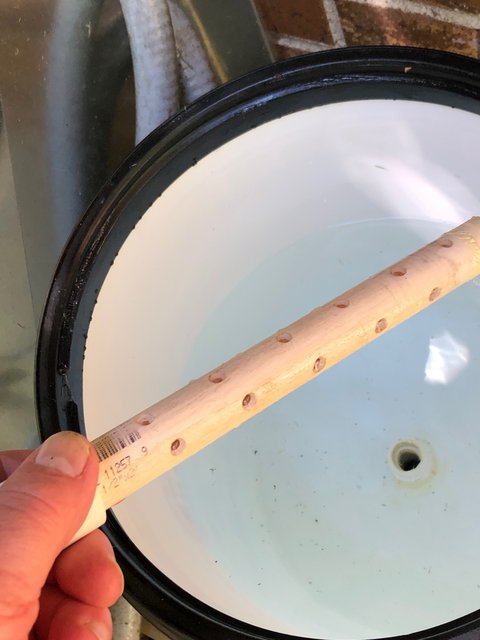

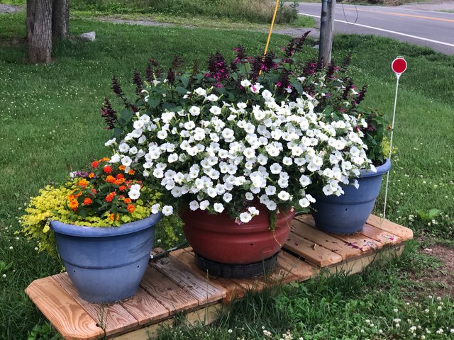

So I got real tired of dragging 150 feet of hose pipe out to water 6 flowerpots I have by the drive entrance and then rolling it back up once a week for five years and counting. I only hod to do it once a week because the pots have built in water reservoirs (another project of mine) that hold about 25 gallons combined.

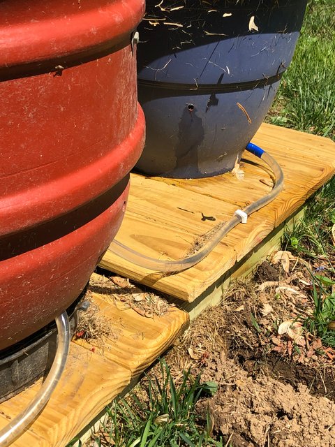

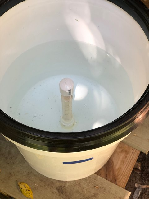

Anyway, I used a small condensate pump I had on hand to catch and pump the condensate water from my AC unit into a 5 gallon bucket that was set up level with the flower pots. A standpipe in the bottom of the bucket hooks to 200 feet of PEX tubing that is buried ~4" deep and connects to the water reservoirs in the pots out at the road. The water level equalizes between the bucket and pots via gravity. If it rains a lot it simply runs out the overflows. The 6 pots are all connected with tubing. I got lucky and crossed the drive at an expansion joint. A few minutes in the fall to disconnect and drain for the winter should be easy enough for freeze protection. I haven’t had to water the pots manually yet this year since putting in the system. If not running the AC for a week or more I can easily manually fill the bucket from a nearby faucet.

The standing water is enclosed in the containers with only a 3/8 inch hole for overflow and the fill pipe, so far the mosquitos have never been found in one and I have had and used some of these pots for about ten years. Just to be sure, some people put something in the holes of their pots like a bit of plastic scrubby or such, mosquitoes aren't to bad here and haven't been an issue. I do put a critter safe donut thing in my bird bath like tatortodd posted, I could add it to the flower pots. I may run a tube from the overflow holes down to the ground as well.

The 6 pots this feeds hols about 25 to 30 gallons and they used that much up in 6 to 7 days in hot weather so I'm using FREE water, saving almost 100 gallons a month in the hottest weather and when the plants are large and transpire a lot. Plus it is chemical free water, unlike my treated public water source so perhaps better for the plants.

The only issue I have seen so far is the clear tubing exposed to the sun, lets algae grow in it. Replacing it with black, or painting it, will stop that.
