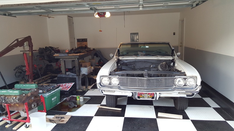

This is my '64 Skylark before I rolled it into the garage last November (2016)
Pulled the engine and transmission and started pulling everything else...

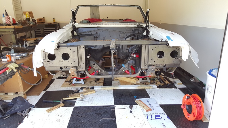

Few weeks later...

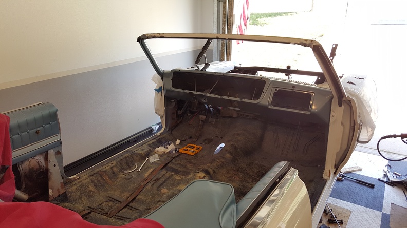

And found, you NEVER feed them at night or get them wet... (like Gremlins)

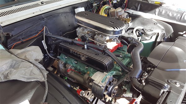

The is almost 100%. I am looking to fire it up this weekend.
All that is left is windshield, exhaust and putting the hood on. All of those after I have the engine, transmission and rear end broken in, as it is easier to tweak things when you can access them.
Did a complete replacement of the entire drive-train, all wiring, complete new suspension, disc brakes, fuel tanks, fuel lines, brake lines rebuilt window and door mechanics refurbished dash, went from auto to 4 speed and some other things.

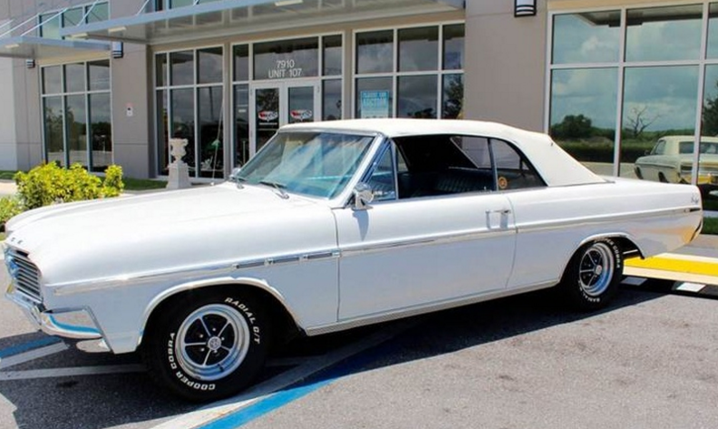

So, took a year.

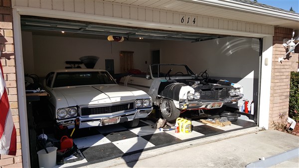

The 1968 is next.
