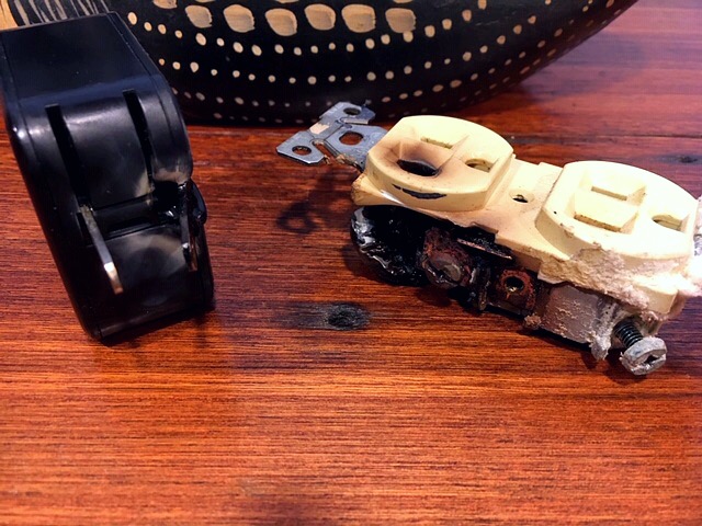

FYI - For those looking to purchase multiple USB chargers, you might want to stick with the items your manufacturer offers.
I’d heard horror stories about off brand chargers in the past & gave them little thought.
Until this one tried burning our house down.
Glad it was caught when it was & the damage was limited to the outlet.
Losing a morning to fixing this was all I needed to learn my lesson.
This one was cooking off while nothing was plugged into it.
I’d had this for a year without any issues.

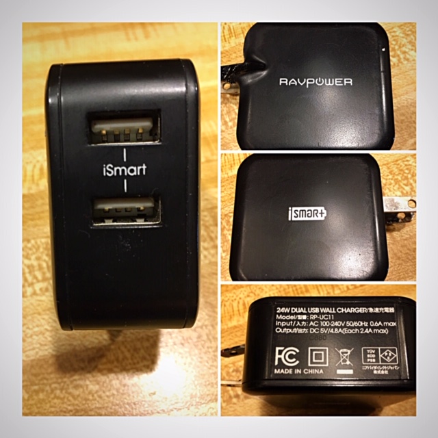

I have a couple of Ravpower desktop chargers that I've used for years with no problems. If one goes out though, I hope it's the one on my desk at work.

I'm not familiar with that brand, but it looks like a direct ripoff of the Anker branded one of that form factor:
I have a few hubs and chargers, along with their braided cables, by Anker. Good product, good warranty, the individual cables I have even have serial numbers on them.

Could this have been a simple outlet failure and not the charger? Last time I bought an outlet it was 99 cents.

Chargers are one of the things that I demand a UL mark on. I notice it's missing on the photos you posted.
Yes, I know they can be forged, but a UL mark on a trusted brand goes a long way in my opinion.
That would be my guess. The prong on the USB charger wasn't making good contact within the socket of the outlet and the heat generated from the increased resistance melted both.
I've had this happen when outlets get loose and don't hold the plugs tightly.

IMO. Looks more like a loose connection on the receptacle itself. Most of the damage was in the outlet box.

jimmy123x
This, it was a loose connection on the back side of the outlet. Not the charger. If the charger shorted (drew too much) your circuit breaker should/would have tripped. Being that the outlet is totally melted where the wire attaches to it, the wire was loose and arching.

GrumpyBiker
Actually this charger had to be wiggled the day before to get it to connect.
I didn’t think about it (my wife reminded me after I’d posted here) but it was plugged into an older three head 9’ indoor extension cord.
I figured it was the cord.
As to the company, I knew nothing of them other than they were offering what I was wanting.
But I’ll certainly be keeping an eye on every charger from now on & unplugging them when not in use.

sns3guppy
The wiring burned up behind the wall and the outlet, not the charger. It's clear in the picture.
Your charger didn't burn up. Your outlet did.

hrcjon
This is the key. If it doesn't have some regulatory mark (*and its from a source where faking isn't a big deal) you don't want it unattended.
