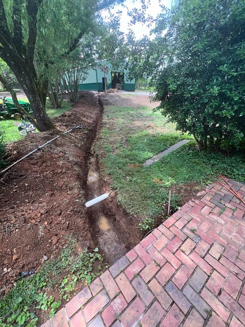

Picture of cparktd
Thanks for the help, and patience! As they say, I even don't know what I don't know when it comes to this stuff.
First off room isn't an issue. See photo below Big Grin
Plug and play... two of my favorite words. Big Grin

So, that vs the cost of fiber @ a bout $50 for the same length and cost of conduit.
Equipment enclosures similar to this can be used in house and barn for fiber demarc and media converters.
https://www.supplyhouse.com/Le...ng_Without_PLTV_data
