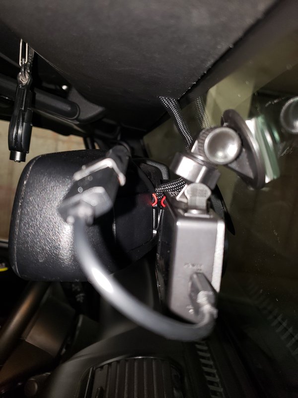

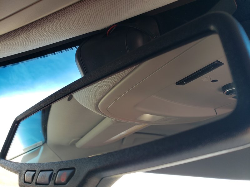

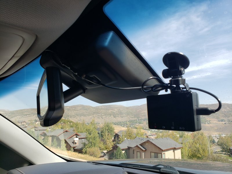

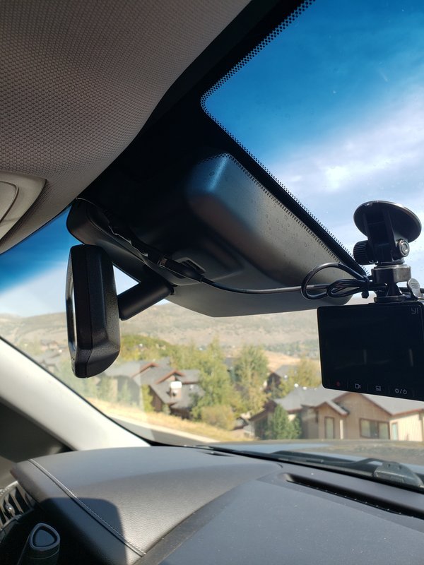

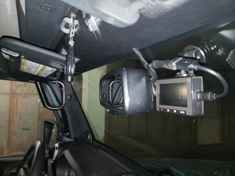

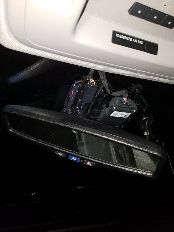

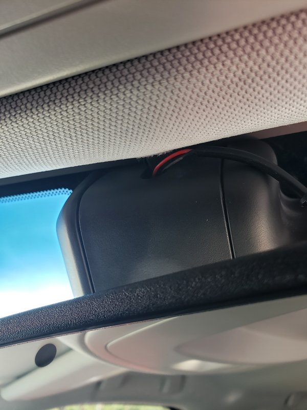

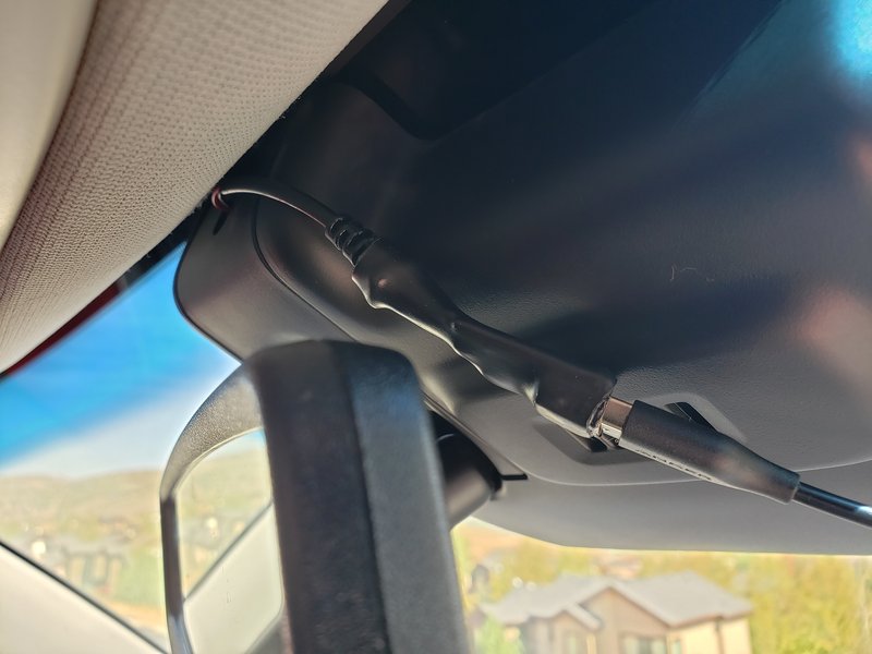

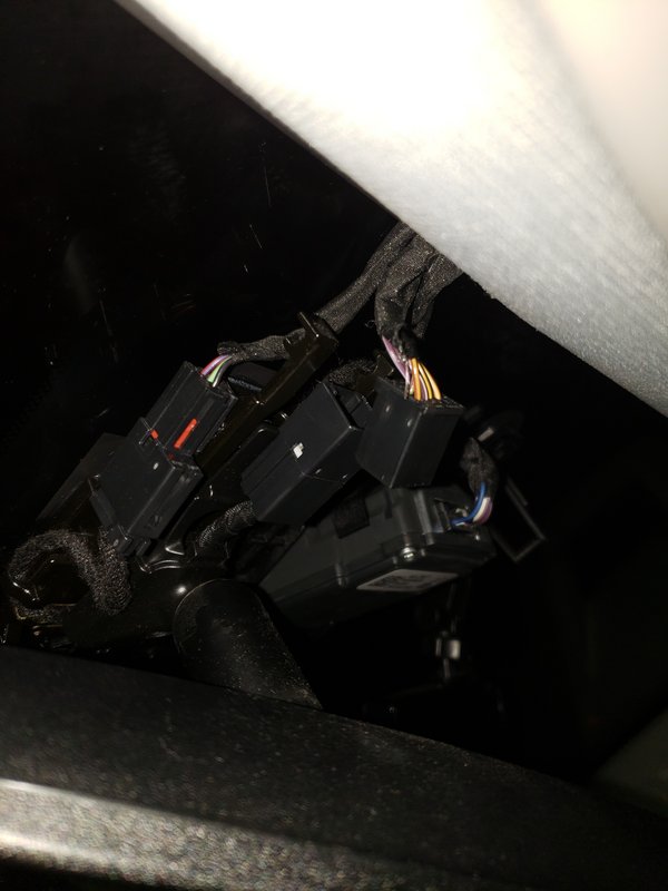

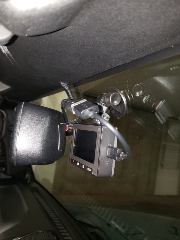

Just wanted to give a quick update to this. I was able to successfully install the universal harness from Dongar Technology on both my Jeep and my wife's 2016 Tahoe. Very easy.
For the Tahoe, I removed the rear view mirror cover to access the harness.
The correct connector is the middle one of the three.
I unplugged it for easier access as the power and ground wires are on the "back side" (the side with the connector clip).
Turning the plug around, the wires to tap into are the #2 (power) and the #5 (ground). The black #5 wire is the one all the way to the left with the plug turned around facing you. I forgot to get a pic of the universal harness tapped into the mirror harness before closing everything back up. Sorry about that; I was drinking.
Anyway, works perfectly.
The microUSB cable that came with the universal harness was too short to reach where the dash cam is currently located, so for now I just used one that I had that was a little longer. I'll likely replace it with a more appropriately sized cable later or relocate the dash cam if the wife wants. Still need to clean everything up a bit, but it's a huge improvement over running a long ass cable to the front of the dash.
The Jeep was easier to do because the mirror was easily removable and has a door on the back to access the harness.
