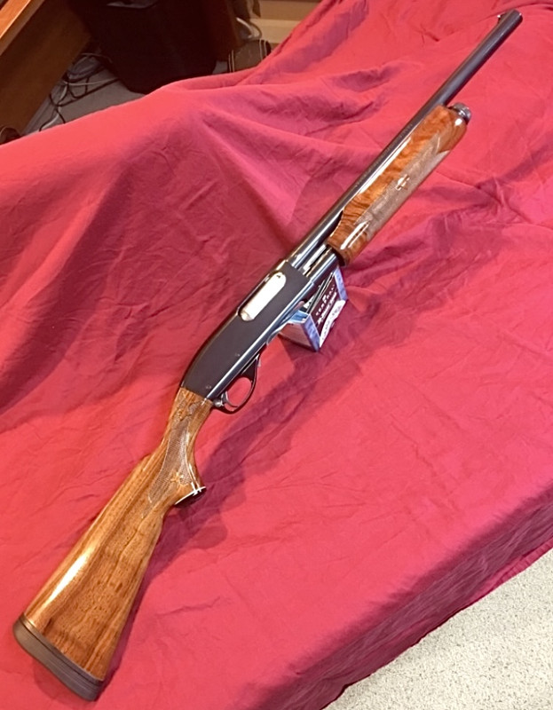

I have a Remington 870 POLICE MAGNUM pump shotgun which eats anything you put through it, Buck, bean bag, ounce and a quarter slug etc. This shotgun I am not worried about.
The question;
The Remington 870 2-3/4 shells, 12 gauge WINGMASTER (currently with a vent rib) 1984 made "V" series serial number. Will this receiver comfortably stand up to buck and slug rounds? Not planning on shooting thousands of rounds through it, say 100 rounds? a year. And the barrel can be swapped to an 18" barrel for shooting.
What are the thoughts on the WINGMASTER holding up and safety issues with the "duty ammo" VS bird/game shot?
