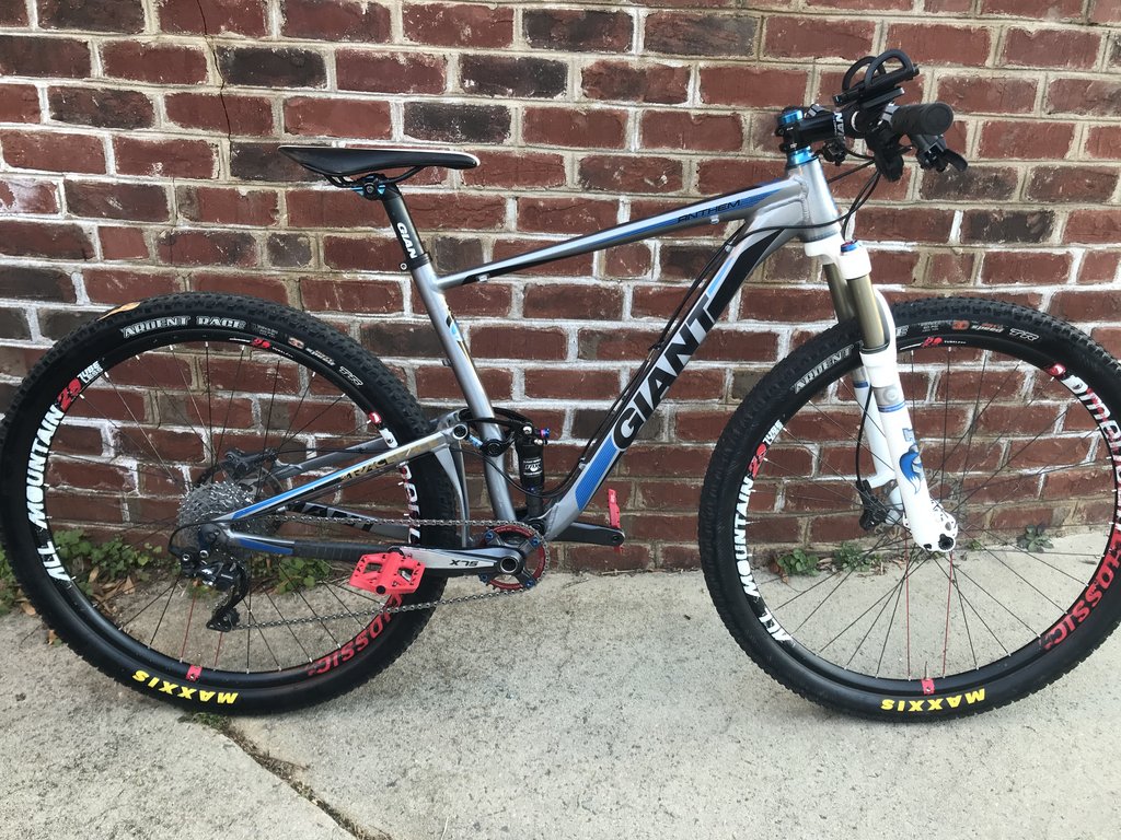

I finally got a decent replacement for my old GT Karakoram! The GT is a good bike but the frame is just too big for me and the hard tail suspension is shaking the snot out of me on the trails I live near.
I figured I could find two nice used mountain bikes for less than the price of one new bike and this way both my wife and I get nice upgrades. I also won’t care as much when they inevitably get scratched and dinged. I’d love to get a new S-Works Epic but that price tag is just a tad high for something I’m going to thoroughly thrash the hell out of....that’s dirt bike territory as far as cost goes. Eek

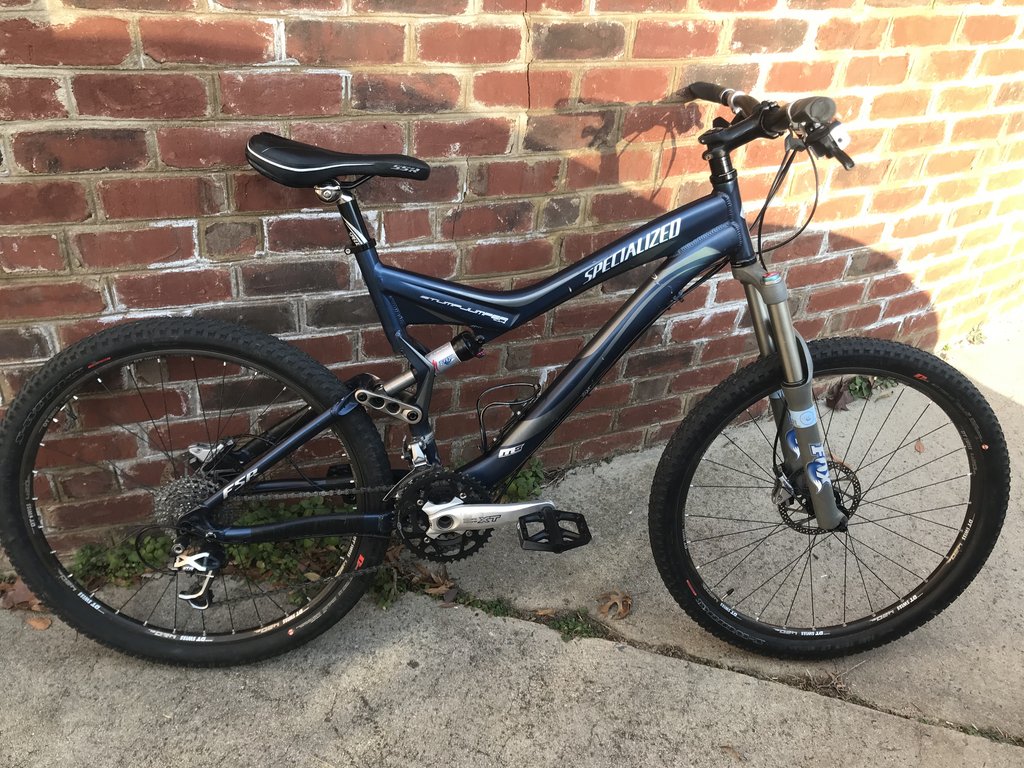

I’ve been slowly piecing this Specialized Stumpjumper together. It’s not done yet but it’s rideable. A swap to a single front sprocket is next as the current set up has too many damn gears and doesn’t like it at all if you are in the wrong gear.

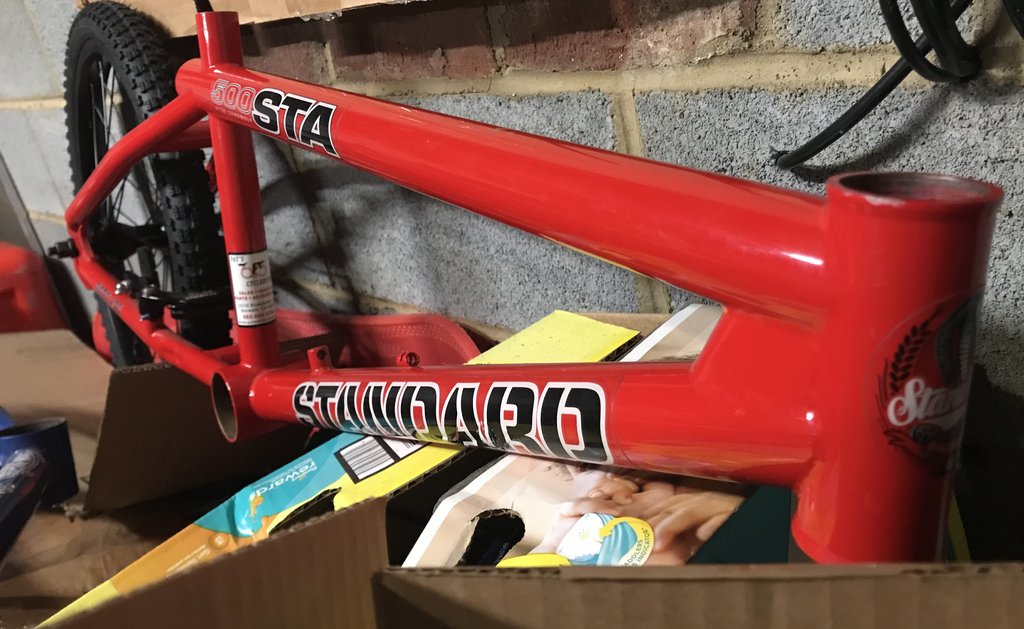

While at my local bike shop getting parts for the Specialized I came across this baby for sale by one of the bike shop employees at a price that was just too tempting. The 29 inch tires of this Giant Anthem feel so different from the agile 26 inch tires of the Specialized.

Nice looking bikes! I also have my old 26" specialized stump jumper. Love that bike. I have two 29" bikes one of which is an E-bike. I still prefer the 26" bike. You used the word agile and it is correct. Long live the 26! My two 29er's handle like tanks.
As for the 26" wheels there are fewer and fewer offerings these days. I found a nice pair of 26" wheels from WTB and they are excellent. Shimano Mavic wheels are good as well.

Last bike for giggles, I bought this 2014 Giant XTC composite hardtail locally through Facebook Marketplace a couple months ago (before I had completed the Ritchey). It had several high-end upgrades, including an XTR derailleur and Mercury race wheel set, and I got it for a reasonable price. I'm riding it as-purchased for now and may swap a few parts next time maintenance is needed. This bike is AWESOME, totally loving it and rediscovering the sweet acceleration and climbing of a light hardtail bike. I've been riding full suspension for years. Took me a couple rides before I relearned the habit of getting up off the saddle in roots and rough terrain, but that came back quickly. This is my first Giant and first 29er, I can't believe how much easier it is to ride over obstacles. Weight is 23.5-24.0lbs.

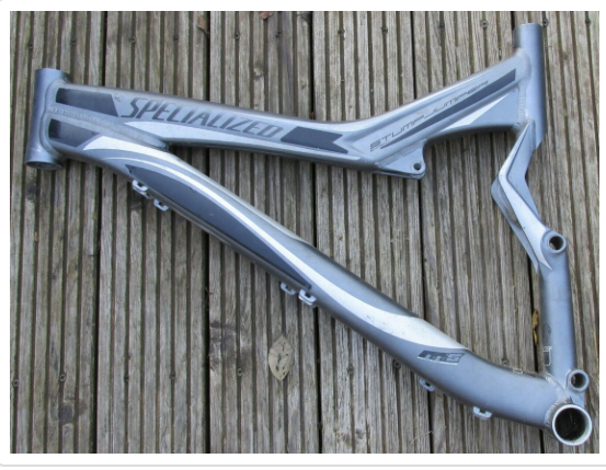

I just picked up a spare 2007 Stumpjumper frame for $19. Eek
How did I get it so cheap? It’s got a huge crack in the down tube. Big Grin
Many would say “Stick why the hell did you buy that worthless hunk of aluminum?” I have some big plans for this frame. I fell down a rabbit hole last night reading about epoxy and carbon fiber repairs on broken aluminum biking components. I think if done right the frame can be repaired.
The down tube was damaged by an impact after being dropped. luckily that area of the frame is not under a tremendous amount of stress.
I’ve been looking at kits like this to convert a bike to electric. Most of the basic kits have a battery that fits inside the frame. They run anywhere from 600-900+ for a complete kit.
It would be pretty cool to modify my Stumpjumpers frame to carry batteries sort of like this bike. Years ago I rebuilt the gearbox in an airsoft gun to handle the modifications I had made and it worked perfectly. To me one of the most fun aspects of airsoft was the seemingly endless modifications available to the gun and batteries. I bet e bikes are fun to tinker with too.

Nice looking bikes motorheadjohn! That Specialized is GORGEOUS! That Giant looks like a lot of fun too. I’m used to hardtail bikes so a full suspension is still quite new to me.
My local bike store fixed the front tire on the Specialized so now it’s practically as good as new! Cool
These two bikes feel so different. The Stumpjumper is way easier to wheelie and it’s suspension is always doing something (I might have it set up too soft currently) The Giant puts more weight on the front tire and has wider bars so it feels completely different. Overall the Stumpjumper is a more confidence inspiring bike. Something about the Specialized’s ergos and thinner handle bars just feels right.

I might have figured out why my Giant was such a good deal. Mad The lower link likely had a small crack that I have been making larger. It took an hour or two of online digging but I found a new replacement part from a Giant bikes part supplier in the UK that said they could source the part from one of their parts affiliates in Holland. I couldn’t find anyone stateside who had a 2012 Anthem Shock D-Linkage and Bolt Set in stock and this company has good reviews and seems to have a knack for sourcing hard to find parts for older Giant bikes.
Now I am at the mercy of the postal system from Holland to the UK. I paid a bit extra so DHL will ship it from the UK to the US. My international shipping experiences with DHL have been superb lately. Hopefully in 2-3 weeks the Giant will be good to go.
