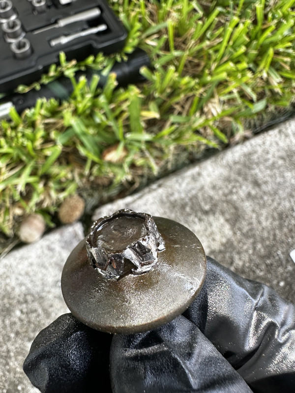

After I saw this thread, I ordered the 41 piece Rexbeti kit as a just in case since I have had to deal with many stripped bolts in my life. I will be changing my transmission fluid and filter tomorrow myself on my 22 year old truck for the first time and today while degreasing everything, noticed the drain plug is completely stripped from some shop that has changed it before. We will see if these work and get the bolt off. I have a new one on hand to replace it with.

I think you will be pleasantly surprised Normin. Good luck.
Be patient. I takes a minute or two to get things set. Remember you are dealing with a stripped bolt. It takes a minute or two to find the right size and then get it to bite. But they work.
Well it worked. The kit has every mm except 15mm, which is the size of the bolt. I had to spend a lot of time hammering the heck out of the 14mm to get it on, but once I did, it unscrewed it perfectly! So happy. Then I ran into a whole other problem and couldn’t finish the job. I changed 3 quarts of transmission fluid, but could not replace the filter or gasket since I couldn’t get the pan out. To get the transmission pan out, you have to remove a stupid shifter cable bracket and the screws to it are hidden so you can even see them, you can barely get one hand up to them, and they are a Torx T40 for some reason! I could not for the life of me get them out. I will try again another day using a pry bar to pry the bracket out of the way instead of removing it.
Here are picks of the bolt after removal.
