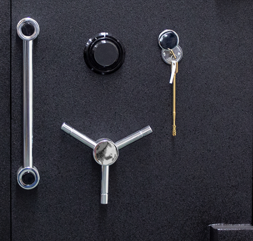

You’re referring to a dial lock. I think konata88 is referring to safes with two locks like this:
Both lock the safe. Both have to be used to unlock the safe. The key can only be removed in the locked position, so the key always has to be used to open the safe. The mechanical lock can be left unscrambled, in which case, only the key needs to be used to open the safe.
