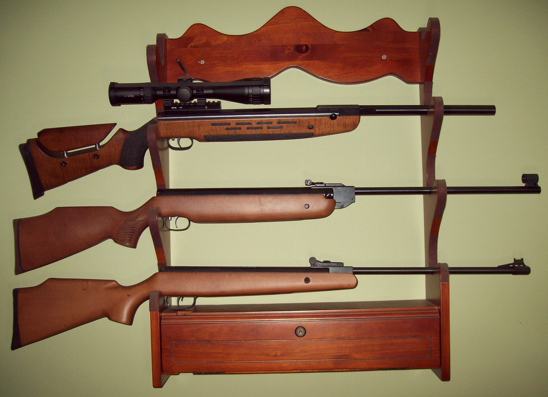

Get a Weihrauch HW30S or HW50S (the 30s is also sold as the Beeman R7.). The HW50 is a bit larger and more powerful but still a middle power rifle.
The 30s/R7 is a sublime rifle to shoot. Easy to cock, forgiving to shoot, light, handy and extremely well made. It’s not powerful but more then enough to take small pests or shoot for a group at 40-50 yards.
I am only putting this out there because it too me a long time to come around to them and they are now some of my favorite rifles of ANY type period.

I am not a hunter and even thought shot placement is crucial with any airgun I personally think the HW30 probably lacks the power to reliably anchor a squirrel. I mean will it kill a squirrel, absolutely. Will it anchor one reliably without a perfect shot, I don’t know and if you are going to kill an animal do it humanely so I lean towards more power. The 50 and up should be no problem.
The D34 is an excellent rifle and should have the power you are looking for. I believe Numrich gun parts was closing out some D34’s at a great price. EDITED-THEY SEEM TO BE SOLD OUT. MIGHT WANT TO CALL THOUGH AS THEY WERE A GREAT PRICE.
Just keep in mind that even the best/easiest spring rifle will require you to develop new skill sets that are a bit alien to us powder burners. Once you develop these, however, your powder burning rifle shooting should become quite a bit better since your mind is subconsciously so focused on trigger pull and follow through.
