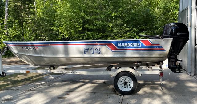

we put a 25hp on ours
<picture of 14' AlumaCraft>

Even if he didn’t mean it this way, lastmanstanding raises a good point: our 16' Lund is built better than they used to be because it was design with four stroke motors in mind.
I don’t know about aluminum boat sealer. My understanding is if it leaks, you have someone back the rivets with a block of some sort while you hammer them a bit. I’ve yet to need to do this.
You need to look at the transom carefully. That’s the back of the boat where the motor would be mounted. They’re usually wood and stored upside down outside is not great for wood. It’s a bit of a project, but it can be replaced if you are handy.
Personally, I like the small aluminum utility boats. They get you on the water for not much money, they trailer easy, they’re easy on gas, and they are relatively simple to maintain. If you found a good one, get it.
