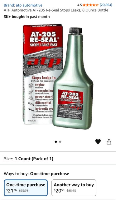

Picture of cparktd
A few years ago on a car forum from a source I trusted, they recommended this for old suspension bushings… Disclaimer: I have not tried it, but they swore by it.
