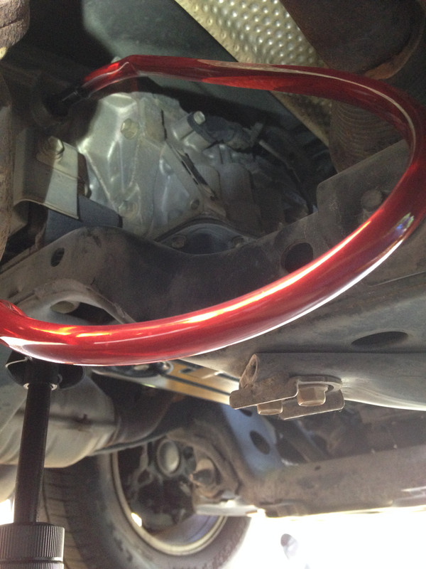

I'm wondering if there's an update from the OP... what did you end up doing, Censored?
I just did the Drain and fill yesterday on a 2008 4Runner. I must say... it's a lot easier on the Acura. With the Acura, you can reach the fill plug from above with a long extension. You can then use a long funnel to fill from above and gravity works in your favor.
With the 4Runner.... the fill plug is hard to get to, from below, and you have to use a pump to replace the fluid. It's kind of a PITA.
