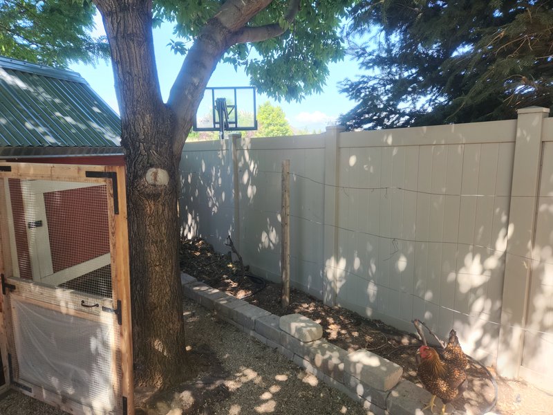

We've got a small chicken coop and run, and a brand new flock of birds. These ladies are very prone to flying over the fence into the neighbor's yard, so, in order to keep them in the run, and also protect from predators, I want to cover their run with nylon netting. Our run is in the back corner of our yard, bordered on two sides by vinyl fencing. Is there some way to attach something like netting to a vinyl fence? Another option, but not one I would like to do, would be to build an interior wall against the two sides of vinyl so I could attach the netting to the wood. Any other suggestions?

Command hooks have an option that is rated for outdoor use. Maybe using some on the outside and hooking the netting into it? Just place the hooks upside-down and stretch the net across?

I use this set-up for keeping birds out of my garden, but it'd work for keeping birds in your chicken run.
The netting: 25'x50' with 1" Mesh (same link also has a 2.4" mesh)
10' t-post from Tractor supply pounded into the ground ~2'. Mostly green, but tops were reflective silver so I painted tops green.
Over top of fence post is a 1.25" x 1.25" PVC tee. I painted green to match fence post. A couple were snug fit over fence post so I hit the fence post lightly with a grinder to make it fit.
Zip tied the netting to the tee.
About every 6 to 6.5 feet I have the fence post and tee set-up.

Thanks for everyone's input so far. To be clear, we're just looking to cover the run with netting, and my question is the best way to attach the netting to a vinyl fence, or am I better off building a wooden frame wall around the inside of the run to attach the netting to?

I suspect that your "vinyl fence" is vinyl covered wood, but either way I would think you can put some screw yes directly into the main posts. Like these:
https://www.amazon.com/YGAOHF-...s%2Caps%2C102&sr=8-8
If that doesn't seem solid, then drill a hole through and use an eye bolt with a washer and nut. Like these:
https://www.amazon.com/dp/B00H...81-df67fc737124&th=1

If the netting is of large enough mesh size, could you not just loop the netting over the vinyl fence post caps?

Wooden frame rail wall would be best. But as I mentioned, the only predators you'll keep out is flying ones. Any ground level predators will be able to get through.
