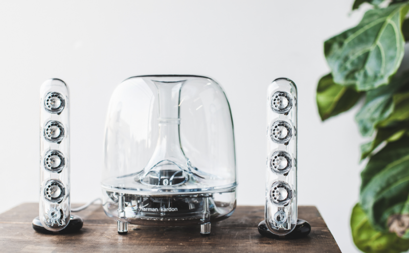

I was going to say stay with HK, my HK Soundsticks speakers sound really great but seems they are kind of expensive now.
As I recall my Gen 1's were non BT, only wired and somewhere around $150.
So these may be way out of what you were considering.
Now seems the new ones are much more but all are also BT.
They look slick and do sound amazing and I am pretty critical of speakers.
As for finding something not Chico > good luck.
I have seen some Bose 2.1 offerings that were quite good, had them prior to the HK's.
HK Soundsticks 4

Yes, I shouldn't have expected much for $23, but audio pricing ramps up so quickly from near zero to unbelievable for marginal increases in listen-ability, even though bang for the buck is a whole lot better than it used to be in the descrete component days. Where the sweet spot for my limited requirements might be, I have yet to determine. Those H-k speakers posted by Schulzy look pretty sweet, but need way too much real estate as well as hard to explain to my budget management staff (she usually indulges me, but gets a little tweaked when spending seems unjustified). Not to mention that we have somewhat different tastes in music.
