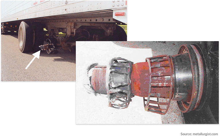

And as shown above, be sure to check or repack the wheel bearings that have been sitting still for extended times. That's a real show stopper.

Can't emphasize enough about servicing the bearings. Bad bearings can wreak havoc on new tires. Agree with others on getting LT rated tires.

More important than either is servicing the wheel bearings. Trust me, you don't want this to happen.
Thanks I get the bearings serviced annually or after I take a long trip, I had the bearings serviced/repacked back in November when I was planning a trip to AZ but had to cancel when I got sick.
