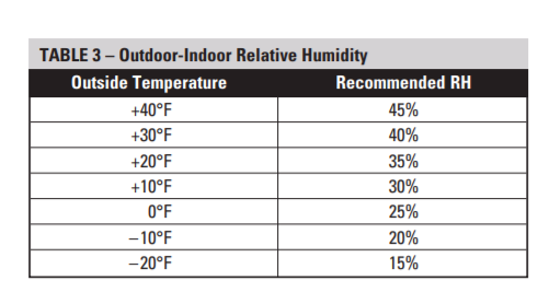

Here's a chart that came with our Honeywell HumidiPRO automatic humidistat:
Those numbers will vary somewhat depending upon how well-insulated the structure, windows, etc.
The way to solve not having to keep "riding" the humidistat with the outdoor temperature swings, and have the maximum reasonable indoor humidity, is something like the Honeywell HumidiPRO we have. AprilAire makes one, too, I believe. So does General Filters.

Most will have a chart in the manual similar to the one below. I just keep mine on 40%.
