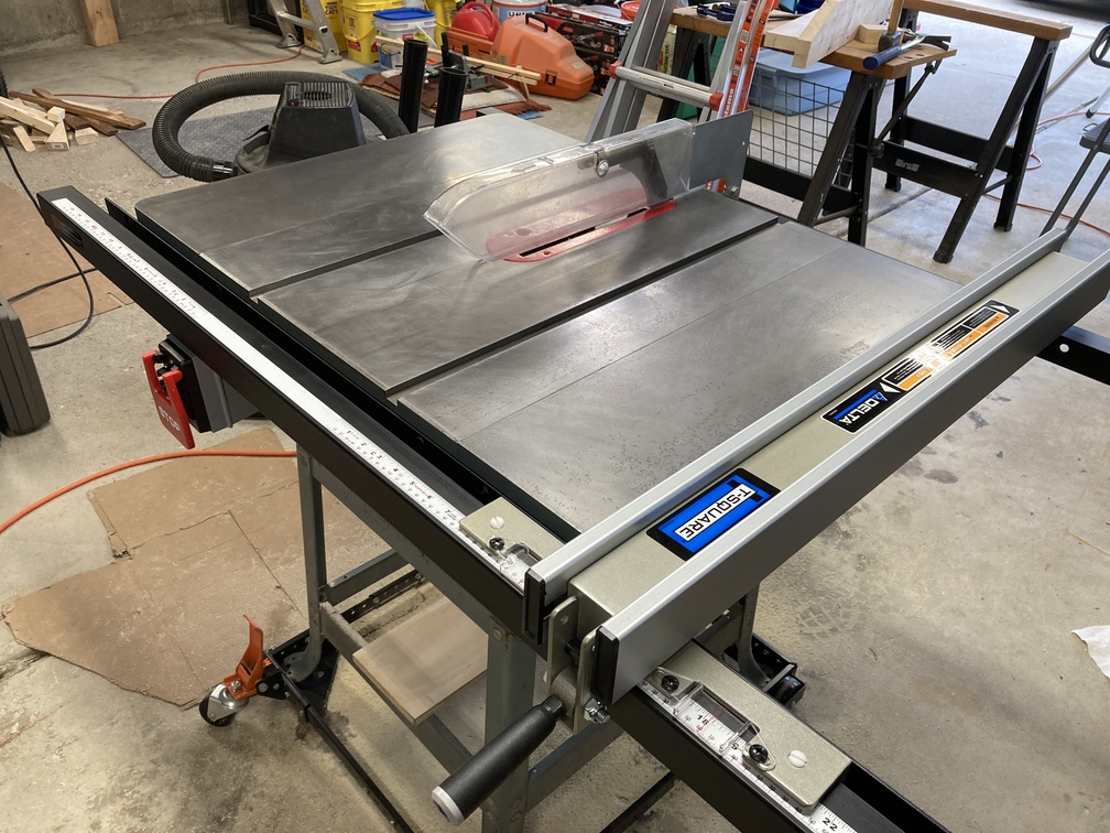

In general terms: Old hardware that can be reconditioned will yield better results than new hardware at the same price point.
I've a vintage Delta 10" Contractor's Saw. (So old the stand has the splayed legs, rather than the straight ones.) I replaced the stamped steel wings with cast iron ones, painstakingly flattened the entire table, and aligned the entire saw with a TS Aligner Jr. If I was careful setting the Jet-Lock fence it would cut as neatly and accurately as any $1,000 saw.
Recently I put it on a mobile base, upgraded the fence to a Delta 36-T30 T3 "T-Square" fence and replaced the simple on/off toggle switch with a big paddle switch, mounted to the underside of the new fence, I can turn off with my leg, if necessary.
Cuts like a dream.
I do need to tear it down and replace a bearing, though. When it's cold the saw screams like a banshee.
Probably have invested $500-$600 in it over the years.
Yeah, that's some discoloration from rust you see over on the right side of the table. I got careless about keeping it covered one time and the next thing I knew... Frown
