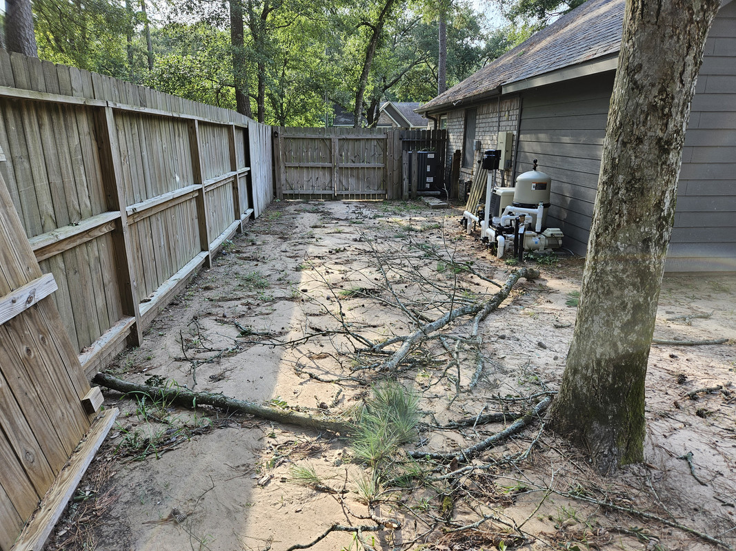

This is where I'd assume we'd put a permanent installed generator, between the pool quip & the A/C unit. Gas line terminates just past the pad for the pool equip
Don't mind the mess, haven't been home long enough to start cleanup from the storm, that limb just barely missed our pool pump.

You don't have the easiest set up it sounds like. If you post or email me some pictures of your electrical panel(s), electrical service/meter, and tell me what you want powered and not then I can make some suggestions and give you questions to ask the installer.
Sending you an email.
