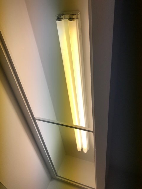

V, can you snap some pictures. Depending on set up would determine how to handle it.
Easiest and cheapest is to buy direct wire lamps, ditch the ballast and run 120v to the new led lamps, which would be T8 now.

For five retrofits I would expect 20 minutes each, for replacement 20-30 minutes each. Often times the older fixtures were directly wired and do not have a box in the ceiling for the fixture. If a box needs to be added (this is determined by fixture you purchase design) probably an hour per fixture total.
I'm not sure of my old companies rates now. I think they are either $125 per hour or $150 now with half hour added for travel.
So retrofit 100 minutes rounded to 2 hrs plus half hour travel at $150 would be $375 in labor. Lamps are typically $15 each or so. Sockets if needed are $3-4 each, that would depend if any are cracked, burnt, or loose. Fixture wire would be about $10. Add markup if contractor supplies materials.
For fixture replacement, best case would be same as retrofits plus fixture cost. Worse case probably five hours and costs for electrical boxes and misc wire nuts and stuff. So at same pricing as above $825 for worse case labor.
This pricing is for an affluent area with high labor costs. I'm sure it would be slightly cheaper where you are.

Photo below. Not sure why the iPhone picked up the yellow color; it's standard "daylight" fluorescent to the naked eye.
These are just standard old plain vanilla builder-grade T-12 fixtures.
I stopped at a local lighting supply place; they recommended LED tubes that will work with either shunt or no-shunt tombstones, $6.95 ea., so the job is really simple, just a re-wire to take the ballast out of the circuit.
I could have done this easily, a few years ago, but age and health have conspired to screw up my balance and I'm not going to stand on a step-stool or low ladder and risk a trip to the hospital with another fractured hip, so I just need an electrician or competent handyman to do the re-wire and get rid of the ballast on each of six identical fixtures, four in the kitchen and two in bathroom vanity areas.

Something like that is ripe for direct wire LEDs. Looks don't matter. Keep the existing fixtures to avoid other issues.
Since you're dealing with strip fixtures, looks don't matter, or the other considerations mentioned previously. 20 minutes each to retrofit, under $15 material each if you replace all fixture wiring and sockets at the same time which I recommend since it's cheap and you don't have a ton of fixtures to retrofit.
With those inputs, other variable is labor cost. Either way labor will be within 5 min if you elect to replace tombstones or not. 20 min x 6 = two hours at your local rates plus travel and gas surcharge.
