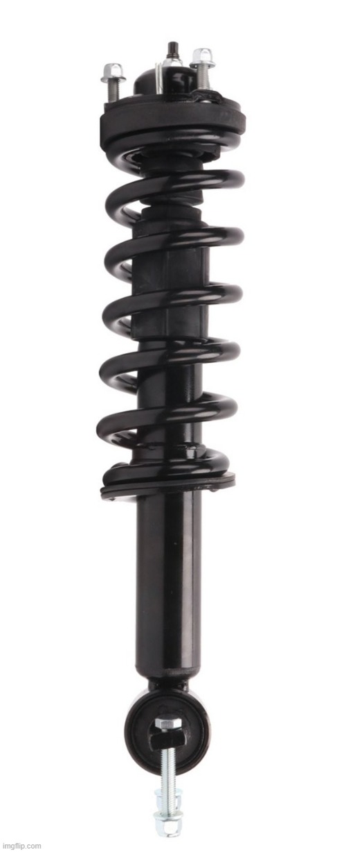

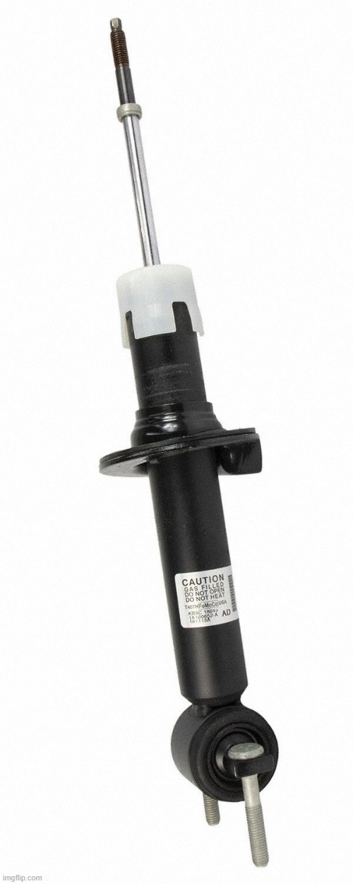

The rear shocks, per Rock Auto, are just regular, typical shocks. The front, however, have the spring on them. (Although they are called struts, I would call them more of a "coil-over" shock as they don't turn with the steering, but this is a minority view.) This might be what the stealership means by "one piece."
You can buy just the shock/damper part.
But I see no point in reusing the original spring and mount. The shop, if any, will also tell you this.
While these springs are not in the extreme compression of most other struts, there is still a hazard. And if these are like the F-series, they may not be very easy, involving breaking the upper ball joint loose. Being 2wd helps as there is no CV shaft to worry about.

An independent shop should be able to do it for a LOT less. The options for the front assemblies are to 1) replace the shock only by disassembling the strut and replacing the old one with the new one, 2) replacing the entire assembly with a new one with the new shock already installed.
Option 1 may be best for the best ride, by keeping the factory springs and replacing the dampers with a higher than normal quality sh0ck, such as Bilsteins for example, and may actually improve the ride, since OEM replacement Bilsteins are single stage shocks, which give a better ride than normal double stage factory shocks. The you woulcd just replace the rear with the same brand yourself or pay the same guys reloading your factory springs, and you would probably have the best possible ride. I did this with my F150 years ago, and the ride was amazing.
Option 2 can be done with original Ford assemblies, but could be expensive from a parts perspective. Or you could buy the Genuine Ford Assemblies and hand them over to an independent shop.
Option 2 can also be done by purchasing ready-to-go aftermarket assemblies, which would be somewhere in between the original factory ride and the aforementioned Bilstein reload option, for considerably less money. But you have to be careful here, because of you buy Monroe or any other Chineseum shit, you could end up in a bad place, since I've never heard on anyone who went with cheap aftermarket assmeblies being happy, somewhere between 99% to 100% of those options are very much hated.
Or you could just buy a top aftermarket OEM compatible brand of assemblies, and be pretty OK .
I've personally done Option 1 and the last option immediately above, and and now due again to repeat one or the other. since I miss the great ride, I'm gonna pay a good shop to reload my existing struts with new Bilsteins, and replace the rear with Bilsteins myself, this will be my third round with Bilsteins in the rear, but I like doing that work myself.

I am fairly certain, if he buys the whole assembly which includes the spring, it is quite affordable and they just bolt right up, no spring depressor needed and no danger. I will be installing new Monroes on my Sienna van soon. Easy job.
