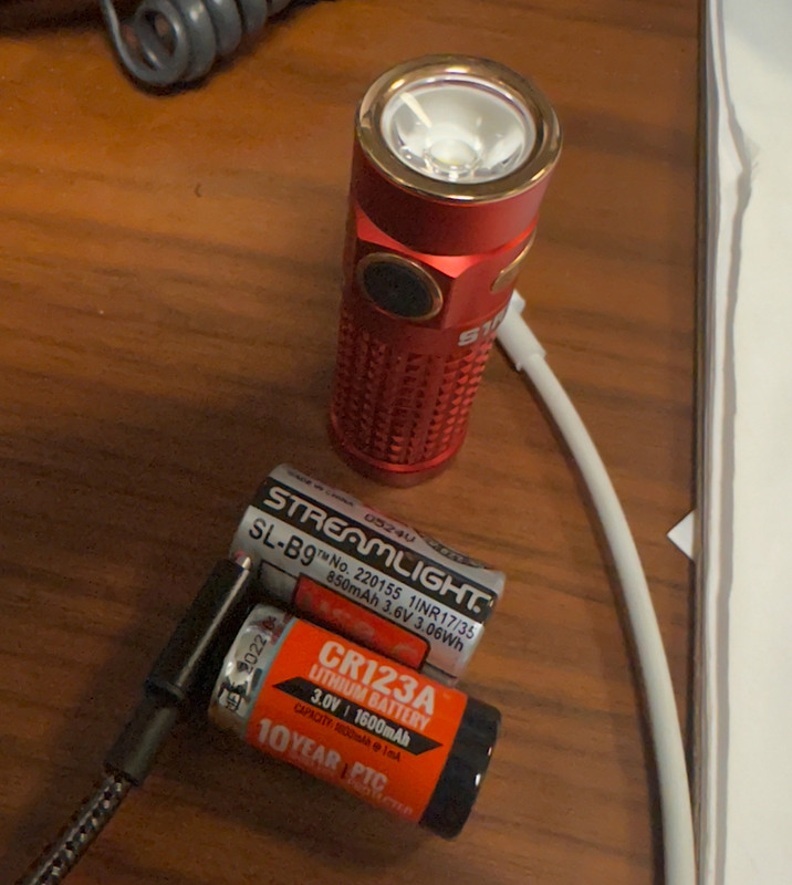

I think the mAh rating is the capacity.
I lost the surefire battery which is rated at 450 mAh.
I have a cheap $1 Titanium Innovations battery rated at 1600mAh. The one I am using was manufactured in April 2022. It's been in my locker with another 49 batteries.
My Streamlight rechargeable is 850mAh.
I'm going to use a 1 cell Olight S1R light set to turbo mode.
I stuck in the $1 battery at 5:40pm. the light is still running at 10:40pm.
I charged the Streamlight and will swap it in when the non rechargeable battery runs out.
I keep all my 123A cell flashlights loaded with regular batteries and they've held up for years in the cars rarely being used.
I'll report back better run times later. But it seems it's probably best to just run primary batteries for long term storage.

We got inundated with calls starting at 00:30. The light was still on when I left. I just got back to station (01:35) and the light is off. So the primary battery lasted over 6 hours.
I've been using the SL-B9 in the TLR-7HLX. I haven't tested max run time on it yet. I'll plug it in the Olight now and turn it on.
I buy the TI regular batteries in 50 or 100 pks from battery junction when there's a sale and a coupon code. Once they ran out of TI and sent me 50 Energizers. These last and I have a bunch, but I'm always looking into rechargeables for lightsaber building. lol
The Streamlight lasted almost two hours
