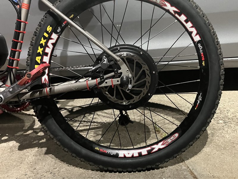

I’ve been tempted by Bafang’s high powered mid-drive but the super sweet efficiency and torque of my hub drive has me thinking I made the right decision for my first build. I’ve done almost 200 fun filled miles on it in about 3 weeks. I like the fact that if I snap a chain I could still theoretically ride home on electric power if I didn’t drain my battery (I’m OCD about keeping it above 40% on long rides).
I’ll build a mid drive ebike soon enough but for now I’m loving the brushless, gearless 48V 1500W hub drive even if it’s a bit heavy. The thing can handle well north of 2,000W without blinking. If you’re pedaling and drawing over 1000W of juice that is a heck of a lot of hill climbing power.
I took my ebike on some single trail today and had a blast. I even met a new Scott Spark owner who is just returning to the wonderful world of cycling. He picked the same color I did with his Spark, Candy Orange. Cool
The zip ties holding the battery have been performing admirably so far. I’d post a video of my ride up but unfortunately the camera was shaken to hell so it’s not much to watch.

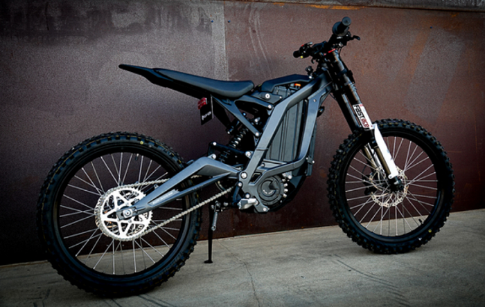

I've been looking pretty hard at these.
https://sur-ronusa.com/sur-ron-light-bee/

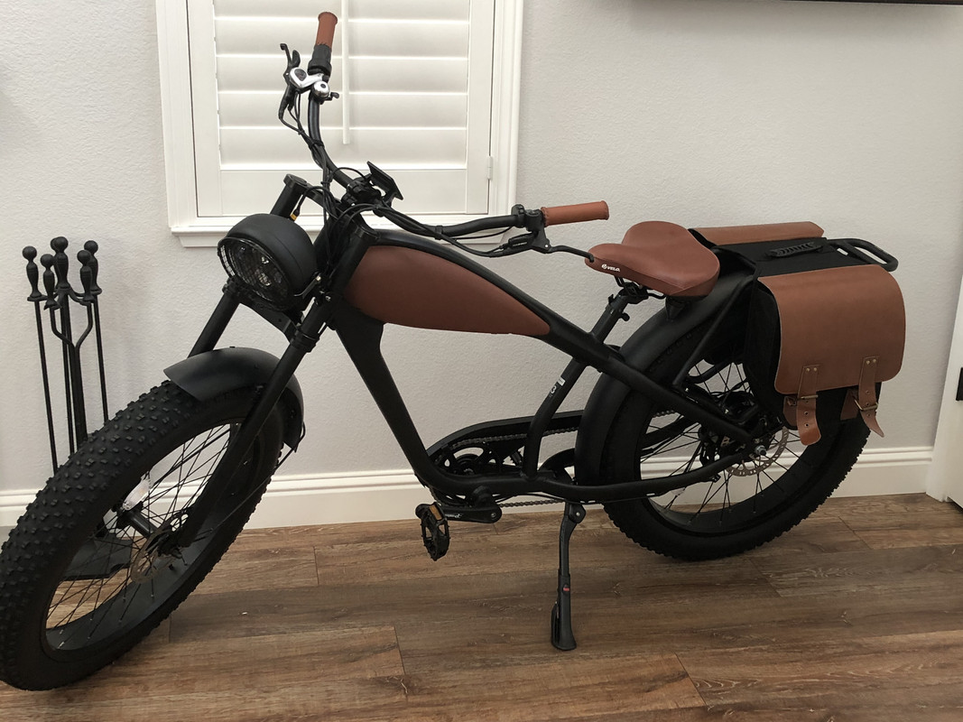

Revi Cheetah Cruiser.
About 3K.
Love cruising down town on my E-Bike.
Pedal assisted or throttle depending on my mood.
28mph max with a 30 mile or so range depending on how much you pedal.

You’re not the only one. Big Grin
I’ve also been looking at them. There are aftermarket pedal kits available so I might be able to ride it on the mountain bike trails at at the HUGE park I live near. If you take off the rear fender, tweak that seat a bit and put on a pedal kit it might not scream electric dirt bike so loud. Big Grin
This bike has regenerative coasting/braking when in sport mode. With all the hills I live near I am quite curious to give one a ride.

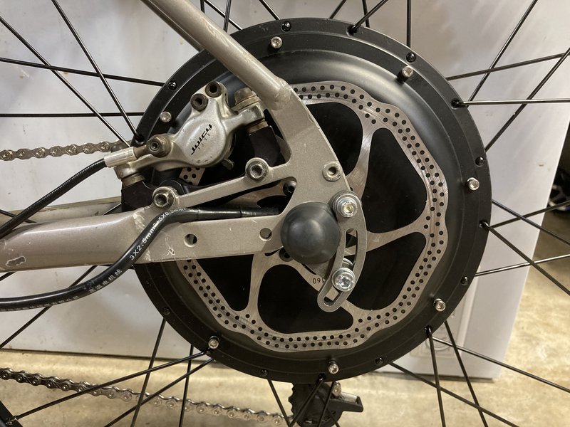

This biking hobby can really pull you in deep. What I thought was going to be a simple rear disc brake upgrade is going to be a little more involved than I anticipated.
I removed my old crappy rear caliper.
Cut the dozens of zip ties securing the wires to the frame.
But then discovered I’d be soon learning more about hydraulic brakes. My kit requires I cut the cable, install the olive and connector insert then bolt it all together and finish up by bleeding the brakes.
As you can see from the pic below the brake cable is not yet installed. No biggie. Shimano brakes look like they are incredibly easy to bleed and all the parts I’ll need won’t cost more than $50. I’ll have a newfound knowledge of the inner workings of my brakes too and be able to cut the cable to size so I suppose it’s a good thing.
Once it’s done I’ll be going from a crappy unknown brand 160mm rear disc to a decent 180mm disc with a brand new caliper.
Posts: 21548 | Location: San Dimas CA, The Old Dominion or the Tar Heel State.  | Registered: April 16, 2007Reply With QuoteReport This Post
I got a little carried away last night with my rear brake upgrade. Big Grin
Eek
Above is the controller which is a rats nest of wires. I had to find the four wires that run from the rear wheel hub motor to the controller and disconnect them. That allowed me to remove the rear wheel and remove the crappy Chinese 160mm wavy rotor and install a proper Avid 180mm rotor.
Much better than this crap it had previously. Old rotor pictured below.
I’ve gotten the bike mostly put back together and just need to bleed the brake caliper today after I install the cable to the lever and bleed out the brake. After watching a few YouTube videos and buying all the necessary parts which were inexpensive it looks very straightforward.
The bikes current state. Not finished but way better than it looked last night. Because of the weight of the bike I improvised my own bike stand. Big Grin

I was up late last night. Big Grin
I successfully upgraded the front 160mm and rear 160mm discs to 180mm and whoa buddy does it stop better now! I also hooked up all the wiring and cleaned up the wires so it looks clean and neat. I’m getting to where I could build one of these kits in about 3 hours tops now.
I even managed to get in a late night test ride. Man it’s fun to have my ebike back and functioning again. Cool I have two usb rechargeable LED bike lights with 2000 lumens total and a wide beam. The light output is easily as good as the HID lights on my Toyota.
I think I’ll be leaving this one alone for a while and building a FWD bike next.
