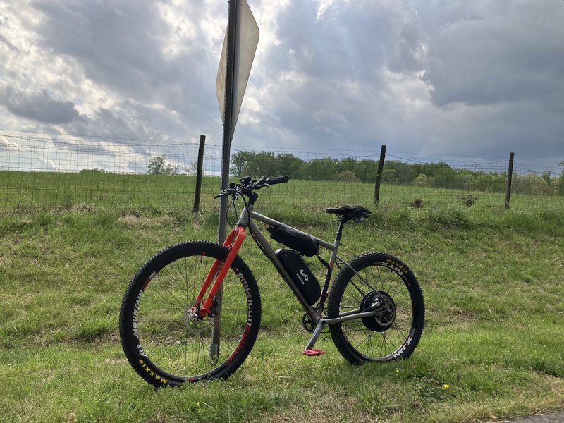

Fast forward nearly two years and I finally completed my own DIY electric bicycle that is very similar to the build I saw on YouTube. I converted a 4130 chromoly steel frame Marin mountain bike into a 52V 2000+ watt electric machine that cruises with ease at 35mph even up hills and has achieved a top speed of 43 mph from a kit that cost less than $1000 not counting the cost of the mountain bike. I chose an older Marin Pine Mountain as my base because it is rock solid and looks a lot like the BMX bikes I used to race in Hampton Virginia only slightly bigger.
Some of the more powerful electric bikes are skirting the line close to being a motorcycle. I can fly through my neighborhood at over the speed limit with ease on my ebike and don’t even have to slow down too much to navigate turns. It’s crazy how a bike that weighs about 70 lbs but cruises at 35 mph handles compared to a MUCH heavier motorcycle.

The bike I built is not exactly a trail bike though I have ridden (and crashed) it on trails. It’s more of an ebike that can cruise for miles on paved sidewalks and gravel trails.

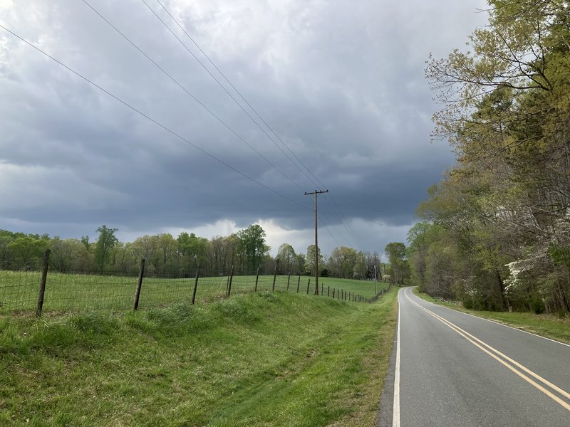

I managed to get in a brief ride into the park in today. The sky was threatening rain and I barely made it back before it started pouring. This thing is so much fun! The bang for your buck factor is amazing.
Posts: 21360 | Location: San Dimas CA, The Old Dominion or the Tar Heel State.  | Registered: April 16, 2007Reply With QuoteReport This Post

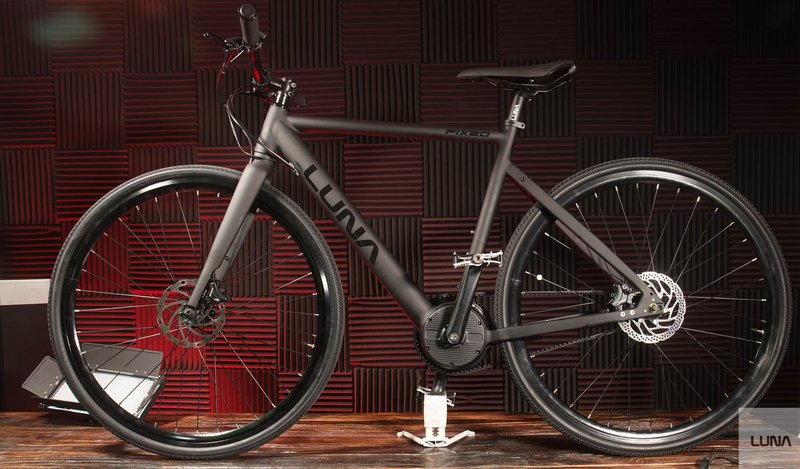

Some of the smaller hub drive motors are so small you can’t even tell it’s an electric bike except for the battery hanging off the frame or rack. There are a few super stealthy builds that actually hide the batteries inside of the tube on the frame.
The Luna Fixed Stealth ebike (it’s not a fixed gear bike) is one example that very cleverly hides the batteries inside the tube. It has a small mid drive motor though but at first glance it doesn’t scream electric bicycle. The belt drive is interesting and it has three speeds built into the rear hub. It’s a very unique design.
Luna Fixed Stealth Bike
From this angle it doesn’t look at all like an electric bike.
From the other side the bottom bracket does kinda give away its secret.
