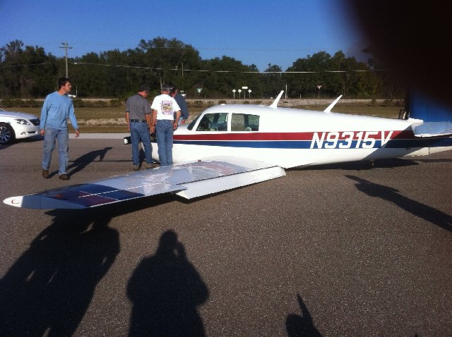

I have many hours of instruction given in Bonanzas (my specialty, along with instrument instruction).
I personally know one ego-driven, incompetent, so-called "pilot" who has done this twice in Bonanzas. The second time was in a Bonanza that his insurance company had paid for, after he destroyed the first one, doing this. When he landed after the go-around, the prop tips were all bent back.
On another note, here is a Mooney at Our Little Airport. The airplane had been in major maintenance for many months, this was the first landing after it was put back in service. Pilot error, not mechanical malfunction:

Very different, however, from touching down on the engine nacelles, attempting reverse thrust (which opens the entire nacelle and slides it aft), then attempting to cancel reverse thrust and initiate a go-around. In a piston engine airplane, it's simply a matter of pushing the power up. In the airbus, or any transport category aircraft, once on the ground, multiple changes take place, and the aircraft transfers to ground mode and ground logic. Especially with power at idle or movement into reverse.
Once on the ground, particularly if ground spoilers have deployed, initiating a go-around is considered no longer possible, and with introduciton of reverse thrust, attempting a go-around would fall on a spectrum from extremely dangerous to impossible. There have certainly been cases in which pilots have touchded down and attempted to go again, resulting in prop strikes, pod strikes, fuselage contact, etc, and in some aircraft, one could possiblly get away with it (eg, MU-2). In an aircraft like the airbus or any transport category aircraft, it would be unthinkable.
