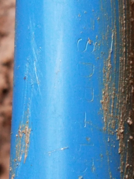

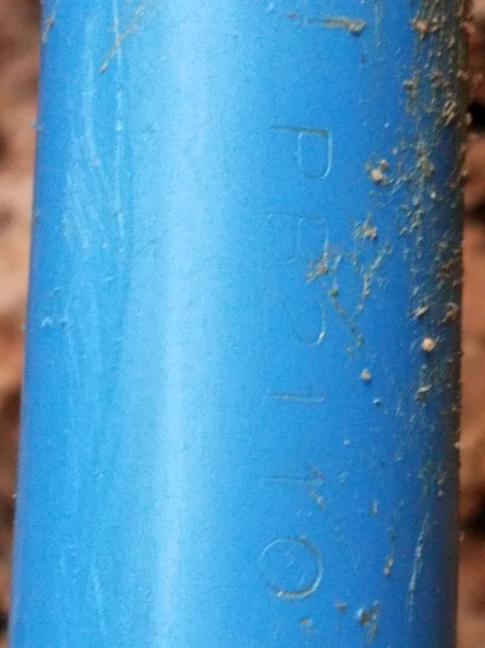

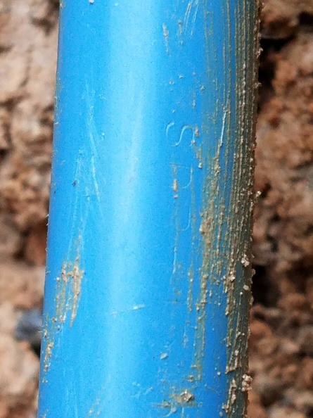

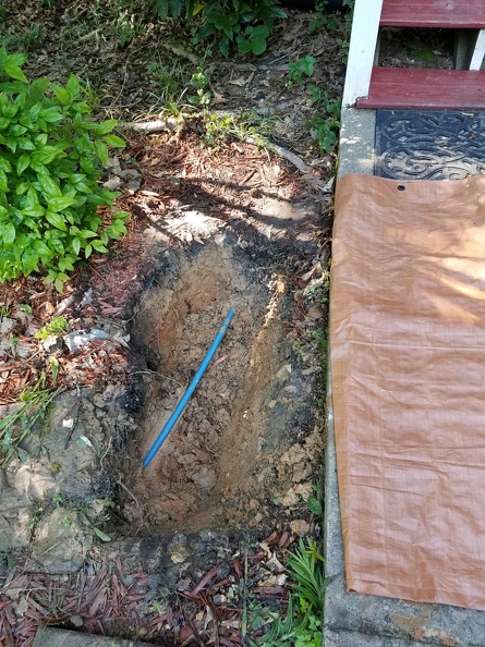

Before cutting:
Pipe markings:
Current repair:

Excam_Man
PB2110 is definitely Poly.
