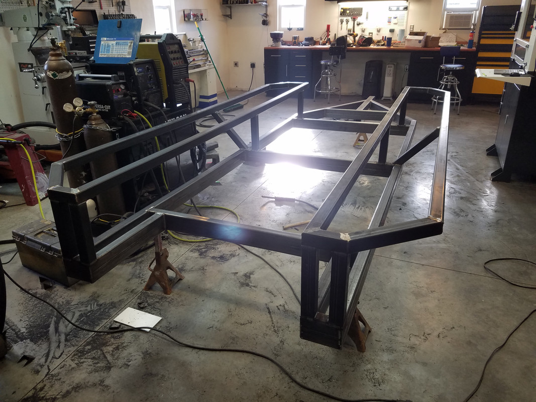

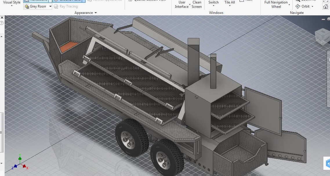

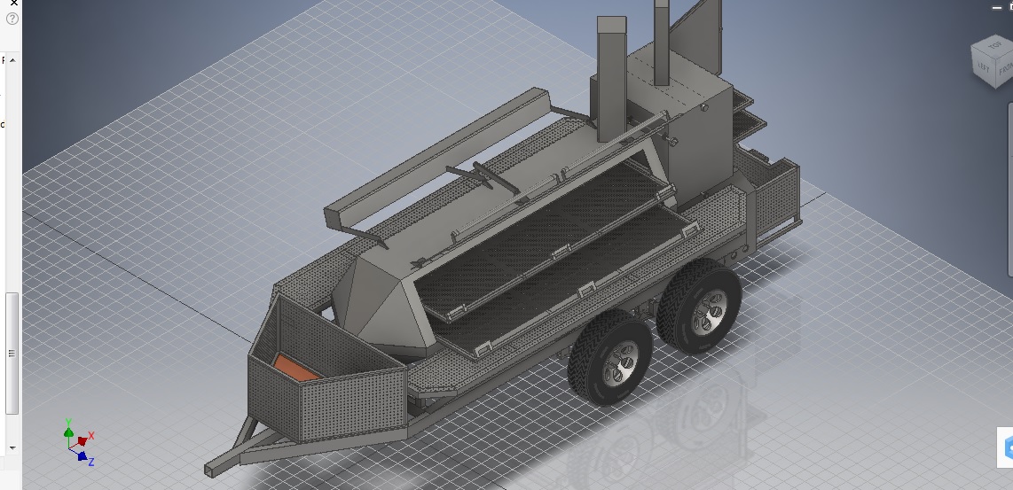

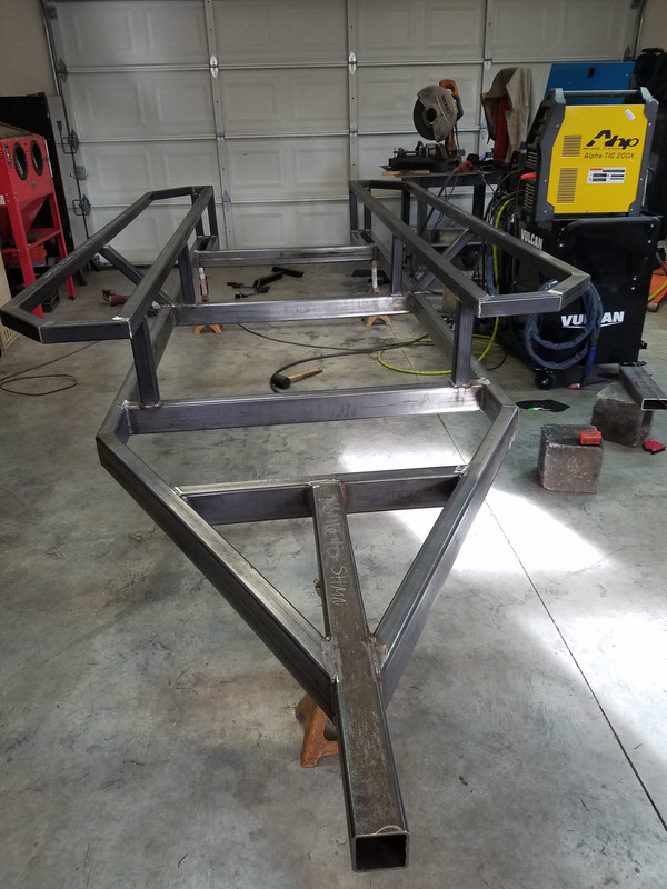

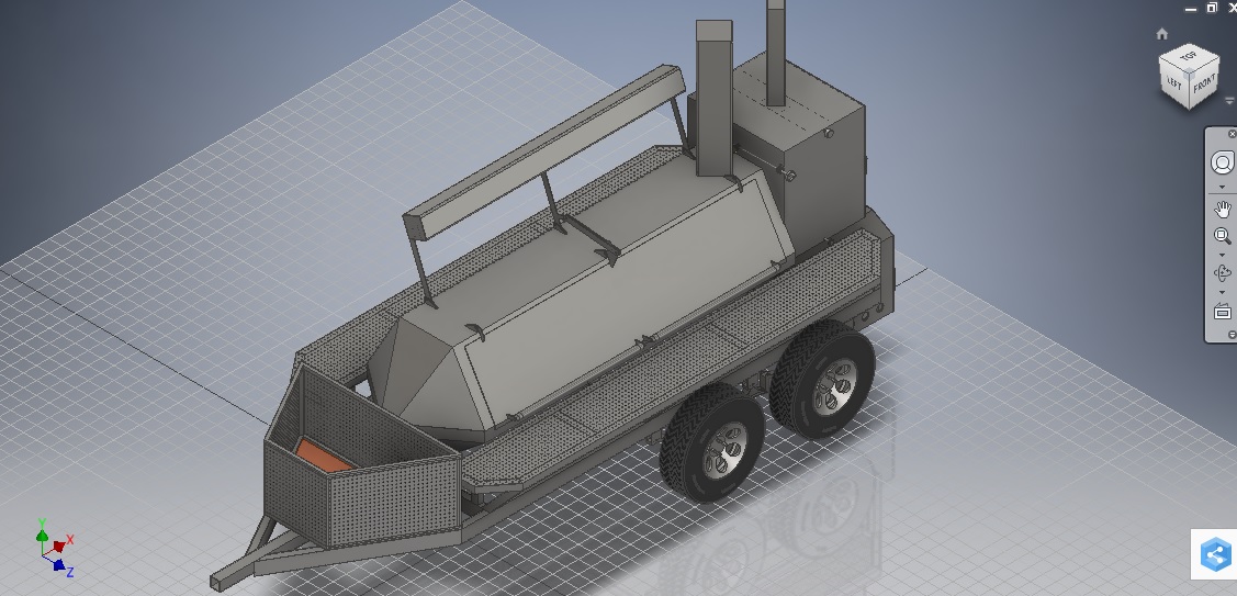

A friend decided to go into business with a local bar/grill. He will be smoking brisket, ribs, sausages and occasionally whole hogs.
I'm designing and building a smoker for his business use. Finished the CAD work a week ago and started fabrication 3 days ago.
The trailer is made from 2x4x3/16 steel beams, all mitered corners and completely enclosed. No open beam ends.
The benchtop areas are 2x2x3/16 steel beams, also mitered corners of various angles. Completely enclosed, with no open beam ends.
The smoker itself will be 1/4" steel plates, cut and welded with lots and lots of strange angles.
Its a reverse flow design, with a 36 x 90" cooking grate, and a second 30" x 90" cooking grate. Both grates slide out, and are removeable.
The thing is 16' long and will weigh 3000lbs. It took a couple hundred hours to design a solid model, create a technical drawing and bill of materials for every single part and assembly.
The door will weight 150 lbs, so I came with an interested counterweight and linkage assembly. It should allow the door to be lifted, remain up on its own, and then be lowerd with minimal without the operator having to lift or pull more than 25 lbs of force at any point in the process.

Any concerns with that kind of heat adjacent to the rubber?

Picture of Ken226
Originally posted by phxtoad:
Nice work!
TL
Typically yes. Thats why im putting an indulated barrier on between the tires and firebox. In addition th the back wall of the fenders, not shown in the CAD drawing.
Tire rubber ignites at 750f. With 10 inches of space, and a double wall barrier, it should be ok.

What software did you use. It looks like Inventor or Fusion 360.

Picture of Ken226
Ken
Good call.
Its Inventor Pro 2017. I took 3 classes on it in college, and have been using it since 2012, and still learning new stuff. Stress analysis using inventors FEA sure is easier than doing it with pen/paper.
Inventor gives me the weight and CG of every individual part, assembly, and of the whole contraption. It'll even include the weight of the welds.
