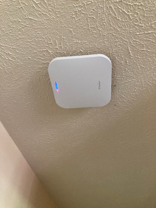

I have this
EnGenius EWS377APv3 mounted on the ceiling about dead center in our 1300 sqft. ranch. It covers the entire main floor, the basement, the attached 2+ car garage, and the back patio. (Though it starts to get a bit marginal on the back patio.)
If we had a 2600 sqft. or better home, a second floor, etc., it might not.
