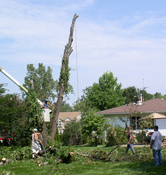

The problem with doing that is the tree, constrained that way, may not do what you expect it to do.
4-6 in. diameter trees, twenty feet high, really shouldn't be all that challenging--if you know what you're about with a chain saw. If you do the cut properly, forming a proper hinge, most times it'll go where you want it to go.
There are, of course, exceptions, such as:
Obviously that last trunk wasn't going to be inclined to go where they wanted it to go, which was left of where that guy in the white shirt was standing, no matter how well they cut the hinge.
Note where they have that rope tied to the tree.
Here it is coming down:
Note a couple things here: 1. Look at the pitch on that rope. The three guys hauling on it were a long ways away. 2. Look at where the guy cutting the tree is looking as the tree started to hinge over. He's ready to get the hell outta there in case it doesn't do what they planned and expected (hoped?) it would do.
Cutting live wood can be tricky. I've more than once had it not do what I'd planned and expected it to do.
