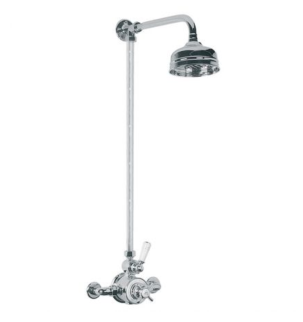

This one is only 6 years old - installed when we built our house. Not sure why it looks so bad. Looks to me like the pipe fittings weren't done properly and minerals and other stuff from the water leaked out onto the fixture.
Any ideas for how to get it looking great again?
It's the mixing valve for a thermostatic shower. Here's what the whole thing looks like:

It was manufactured and purchased from Lefroy Brooks, a quite reputable British manufacturer of kitchen and bath hardware. Expensive enough that I'm embarrassed to disclose the price.Faulty plating would surprise me. Maybe it's a bad picture...in person, it looks to me like mineral deposits that are dripping down from the various connections.

"Lefroy Brooks is a line of English-style faucets, fixtures, and accessories for the kitchen and bath. They were originally manufactured in the U.K. but today they are made in China. Distribution in the U.S. and Canada is through Lefroy Brooks Plumbing Fixtures, Inc. founded by Warren Pearl in 2009. Mr. Pearl is also the owner of Cooper & Graham, a luxury bath brand launched in 2014 that caters primarily to the hospitality industry."
It's a real shame when a great company goes cheap on manufacture, but still charges a premium price.
