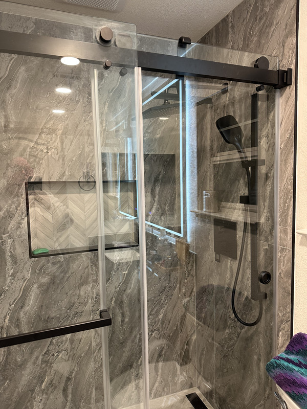

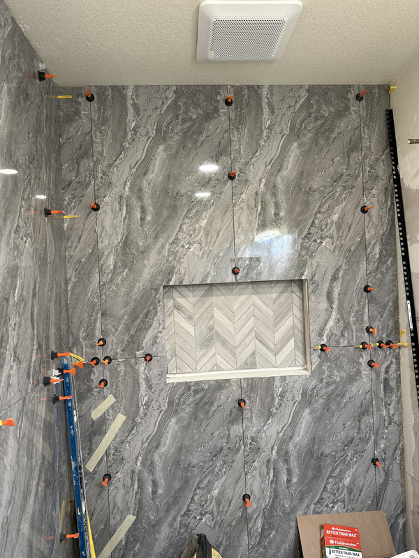

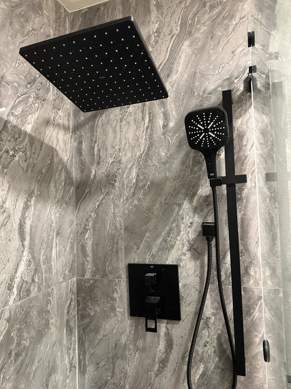

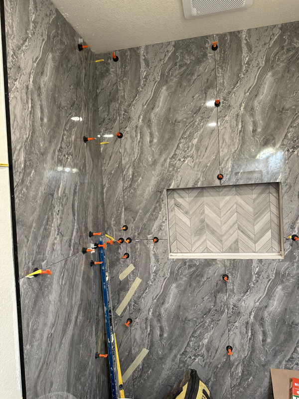

We just did 2 bathrooms with quartz sheets. Highly recommend them.

What kind of sealant in the corners? Caulk or grout?

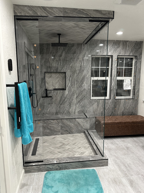

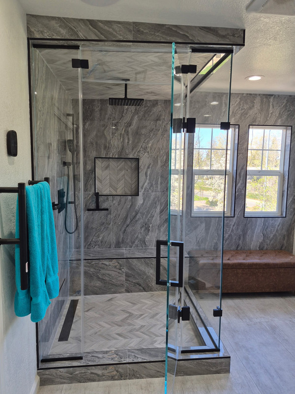

I like the quartz!! Questions: floor slippery when wet? Anything special required to make sure it’s not slippery? Or use different material?
I’m looking to make the shower curbless. Does the trough drain allow for flexibility to change the shower floorplan slightly while still using the existing drain pipe (in concrete slab)? Or did you have another reason to use the trough design over a small circular drain?

I think grout. I didn’t do the work. It also has metal edging, top and sides.
It’s a very tight fit so the seams are very thin.

@konata88, bathroom quartz is man made. They make some that is made for the floor with a nonslip surface. They usually have some that matches the walls. Not available in all "colors"
If you are on slab, the current pitch would determine the best way to do a curb less shower and drain choices.
I had to tear up my floor to sink the shower pan and re-pitch the whole floor to get it curb less with no threshold into the bathroom.
There are many ways to do a curb less shower. The current set up is going to determine the best method and the overall cost.
I picked a trough drain against the back wall since I pitched the floor that way.
