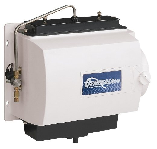

We have one similar to this:
Product page: GeneralAire Model 1042LH
It uses a "vapor pad" over which fresh water runs. Installed properly: The water only runs when the furnace is still firing.
Upsides: Always fresh water. No pad, etc. to get nasty. No float switch to fail or malfunction. Downsides: Pad has to be replaced annually. Has to have a drain for excess water.
It does kick out serious humidity. Too much, if you're not careful. We had moisture condensing on the ceiling along the walls on the western and northern exposures a couple winters. So much that I originally thought it was ice dams on the roof. Finally fixed that problem last winter with one of these:
Honeywell HumidiPro Digital Humidity Control
Outdoor sensor (wired) automatically readjusts the max humidity allowable based on outdoor temperature.
