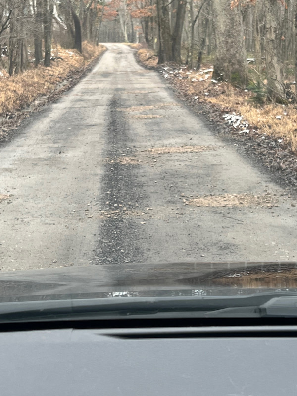

State road finally fixed our road! After swerving to miss some but still hitting potholes too numerous to avoid since Summer, a 2-man crew came out with a small load of crusher run and filled the holes. Smile
Of course by 4-5 weeks the stone will mostly be pushed out and the holes will be back, then Spring comes and it really gets bad. But I get to enjoy month of not swerving and smooth driving! Big Grin

Or until it rains. I've been maintaining a gravel driveway for 30 years so I know a little about potholes.
That's not a fix, that's a patch.

Road, what road?

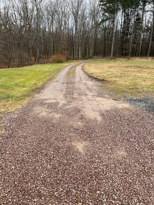

Paul I'm fortunate that the excavator who put in my drive 20+ years back did a really good job. I wish the State would dig up the road and lay a proper base in but in reality I'm fortunate they just fill the holes a few times a year. My excavator took all the organic dirt off and more, then brought in 100 or more tri-axle loads of strip stone and rolled it down 1'+ deep. There's never been any holes or ruts in this drive in spite of a *lot* of heavy truck use, lumber, drywall, concrete trucks from construction. About 10-11 years ago I finally added a 2" cover of 57 stone right before a logger came to remove 450-500 pines. He told me up front his logging trucks will rut the driveway and I need to plan for that, but after they finally finished he couldn't believe there was nary a rut anywhere in the driveway, only the few places trucks got off the drive.
This image is of the worst section of the drive, low where water lays from heavy rain or snow, and after all the logging and shop building construction it's still not been touched. I do want to put an inch or so of 57 there just so I'm not walking through water during heavy rain.
I should add that the freshest looking stone toward the bottom of the pic is right in front of the walk to my porch so I did spread a couple bucket loads of stone there so I wouldn't have to walk through an inch of water when walking back and forth from the house to the shop. That's what needs continued up beyond the trees but I'm out of gravel.

I know, not much of one but it's what I have. Frown

At least they used something with dust mixed it to fill them! Has a chance of at least compacting a little bit. Your contractor did a great job putting the original base in, most of them are lucky to even strip the topsoil off anymore.

Very true, they started using crusher run or millings instead of stone for the holes a couple years back and it packs much tighter. Lasts a month or so instead of a week.
