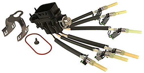

Two things commonly go wrong with this engine - fuel pumps and injectors. This type of injector must have a minimum fuel pressure of 55 psi, even at the lower voltage present when cranking. If it only puts out, say, 51, 52, 53, it won't start. The other problem it has is the injector "spider" itself.
The large "body" in the center contains the electrical part of the injectors and the silver object is the fuel pressure regulator. At the ends of each of its "legs" are little poppet valves. These have been known to stick. When the engine finally starts it will miss for a few seconds until they become unstuck. This feels somewhat like the engine flooded. It can also leak. If you pull the upper intake manifold, everything should be covered with a layer of brownish-black crust. (This is normal.) Any areas that are clean and shiny are leaking because the raw fuel is washing them clean. If the fuel pressure regulator is leaking, a spot on the lower intake manifold below it will be washed clean. An improved "spider" that has the injectors out on the ends of the "legs" is available.

Thanks egregore, that sounds like a probable culprit.

Try several key on engine off cycles before you crank. See if this builds fuel pressure and helps with starting. If so, suspect pressure regulator but pressure testing of the pump is necessary.
I lost count on the number of injection spiders I replaced due to a poppet failure. I also was seeing leakage near the pressure regulator due to cracking.The updated spiders are gtg.
