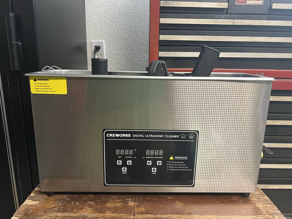

Pictures for scale and dramatic effect. I went with the wide version to see what I could fit in there. Relatively pleased so far. I'm not going to do a whole gun like this, probably. I have some glass jars of various sizes. For the inaugural run, I'm gonna put some suppressors in a pickle jar and fill that with a mix of Simple Green and water, another jar with my glasses and some diluted Simple Green, and some old pocket knives in another with, you guessed it, Simple Green and water. I'll fill the rest of it with hot water from the tap so the heating element doesn't have to work so hard, and this way the inside of the tub won't get filthy every time I use it. The glass jars transmit the sound waves just fine. I've read that plastic inhibits the effect somewhat, or I'd be using those over the concrete garage floor.
Stay tuned for results.
Oh, and because someone will ask, here is the link. It has fluctuated a few dollars over the last few days. It was $146 shipped with a $25 off Coupert automatic coupon thing, so if it works like it's supposed to, I'll be pleased.
https://www.amazon.com/dp/B0C8HLX74T
Oh, and before anyone judges me for the filthy toolboxes, that's 30 years of my old man's neglect, fresh moved from New York. I'm yet to clean all that crap off yet, and the ultrasonic is part of the process. His tools look just as bad, or worse. It's all getting scrubbed fresh and clean before I organize it and put it away.

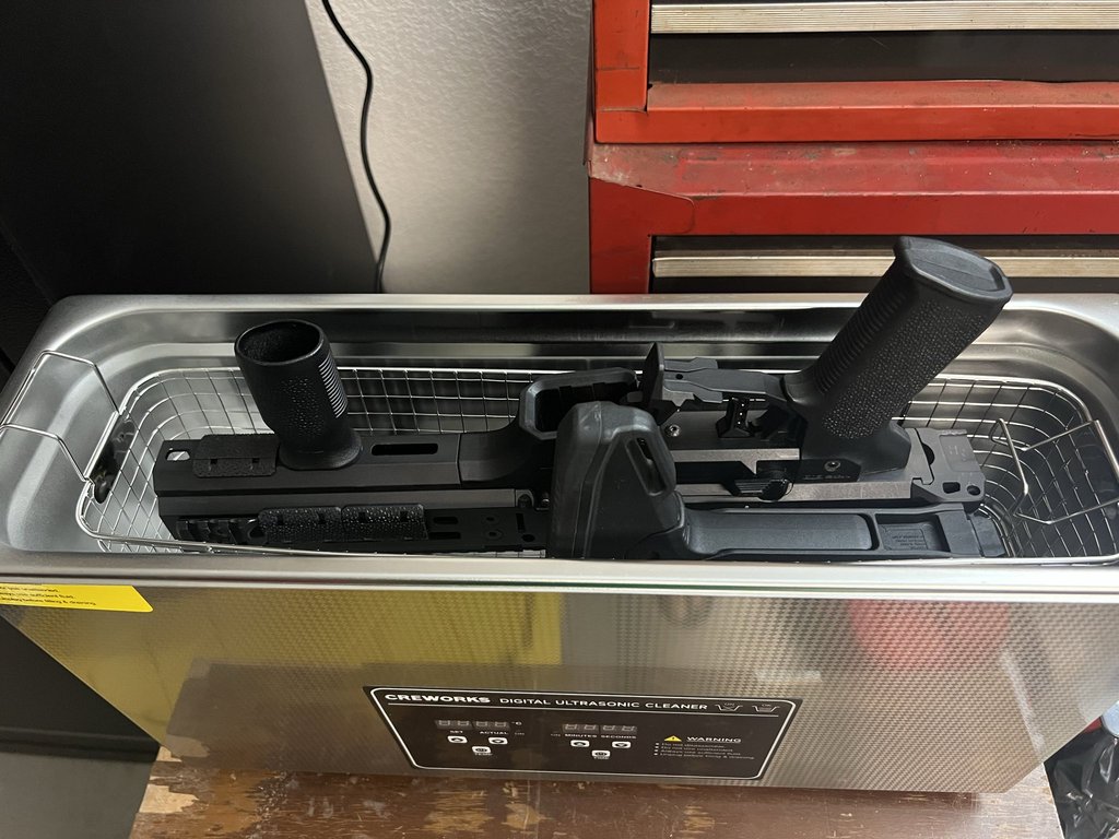

Well, thanks for the feedback, guys. I have enough time messing around with it now that I have some thoughts to share.
First of all, this thing is awesome. I don't like throwing around the term "game changer" because I think it's cliched and overused, but this thing is absolutely that.
If you have and use suppressors, I think one of these is almost required gear. If you do, you know how much crap they blow back into the gun and how fast your guns get absolutely filthy. Before I got this thing, it would take me a couple hours of cleaning for several rifles after a range trip. For about half a tax stamp, you get something that's going to cut your cleaning time down to nothing. I detail strip, submerge up to the top rail, run it at 50c for 15 minutes with a couple spritzes of Simple Green in the water, and then it's just a matter of wiping off the loosened crud, which works in concert with the heat to dry it. That's it. Oil/grease, and reassemble. Hasn't stripped the anodizing off anything, but I'm going to go ahead and order their aircraft grade solution today anyway just in case.
As for the suppressors themselves, I took measurements and after some looking around, ordered this four pack of juice jars. They neatly fit my Polonium, which is so far my biggest can, plus the others, all tubeless so no disassembly required or allowed. A couple glugs of Simple Green and two 20 minute heated cycles is enough to turn the water black. I take them outside and blow them out, and then what I can see of the blast chamber and baffles are shiny enough that I call it good. Maybe some day, some more in-depth cleaning for carbon buildup will be in order. Perhaps in a tumbler with some sort of media, but for now, I figure a quick bath after every range trip should be enough to put that off for a long time. Tubeless lifestyle and all that.
I've thrown whole Pmags in there, then wiped the fouling off the follower and feed lips with a shop towel, and just shook them out and let them dry. Works great. Glock mags, same deal. I did notice it ate the finish off the rear sight on my G45 slide, but that doesn't even move the needle on the meter of things I care about. Speaking of, that was also a refreshingly easy clean: I just detail stripped the slide, briefly thought about stripping the frame and thought "hell with it" and in it went, whole. Came out looking factory-new.
Oh! That reminds me. I ordered this set of baskets, which was totally worth it. The little ball-shaped one is great for springs and screws and whatnot, and the bigger one neatly fits a G19 sized RSA and all the slide parts. For $8, it's worth it.
I had some rusted-out knives I inherited or was given and experimented with those. I ran an old Case Trapper that was rusted shut through it enough that I can open it and close it, and worked most of the rust off the blades. However, the amount of time and CLR it took to get that far started to destroy the scales. They went from being smooth Delrin to looking like frayed wood one would find washed up on a beach somewhere. That's ok, it was a total loss already and purely an experiment. The rusted Barlow I was given wasn't as bad and I didn't run it through there as much, but it somehow started to plate the metal with something and it gave it a coppery finish. Kinda cool, but the knife still isn't in a state where it's all that usable.
I think it's definitely a keeper. It works magic, but only to a degree. Given my experimenting with the knives, I can absolutely see how someone could destroy the finish on a gun, but I think it takes more time, heat, and solvent than probably a lot of guys would like to admit to. 20-40 minutes so far hasn't been enough to do it, but I go easy on the solvent. Dawn dish soap does a better job than I would've guessed. The guys with the horror stories must be dumping a lot of Simple Green in there. Which also reminds me: A glass jar with hot water and a splash of Dawn is great for eyeglasses and NATO watch straps. I had some NATOs that were so filthy I couldn't get them clean with a brush and hot water anymore, and they look brand new again. So many uses.
