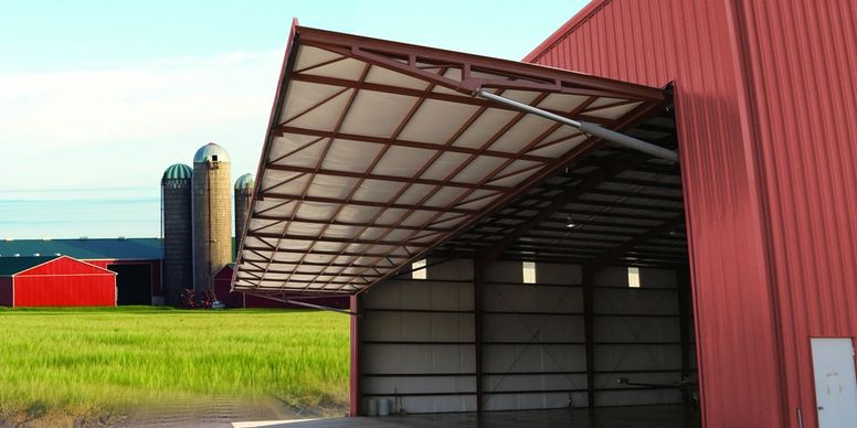

Main door of the hangar is approximately 20' high, 40' wide, weighs a few tons. It is supported by a row of a dozen or so hinge sections along the top -- these hinges are welded to the door and to the door frame.
The door pivots on these hinges; it is opened by two hydraulic cylinder / piston assemblies, one at each end. The door is pushed outward and upward to open. Photo is not our hangar, but it shows the type of door.

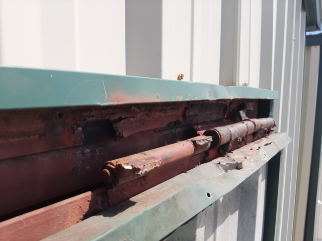

Here's a photo showing one of several broken hinge areas in the latest (current) failure:

I have worked on quite few overhead doors, none that big though.
Hard to tell from your picture but first glance it looks like the hinges might be out of alignment causing stress on them.

Do I see some corrosion ? That can't be good .

Big door, or not so big, depending on your frame of reference. Yes, this is big, but the smallest size at Our Little Airport. The developer laid out hangar lots standardized on three widths -- 50', 70', and 100'. The hangar that I lease is on one of the narrow lots, so the door is "only" about 40' wide. Many (most?) of the hangars with similar doors are on the 70' or 100' lots. Door failures like these are extremely rare; I only know of one other, whereas my hangar door has failed like this four times. One of those (the third one) was caused by a doofus who operated the door improperly, but the first two instances, and this one (the fourth) were seemingly random failures.
I too, have questioned alignment. The outfit that repaired the previous similar failure a year and a half ago, stated that alignment was proper, but I'm not convinced that they were correct.
It looks like the weld itself is breaking. With good welding this shouldn't happen. The metal next to the weld should give way first. This may be in conjunction with a misalignment or binding somewhere.

Looks you really need some sliding doors. The way that one is designed puts a lot of stress on those hinges and is probably way too much weight for the intended application. If you need that style door, having it pivot on the ends with a counter balance of some sort would be my preference and much easier to maintain. However, it may sacrifice some head room you may not have.

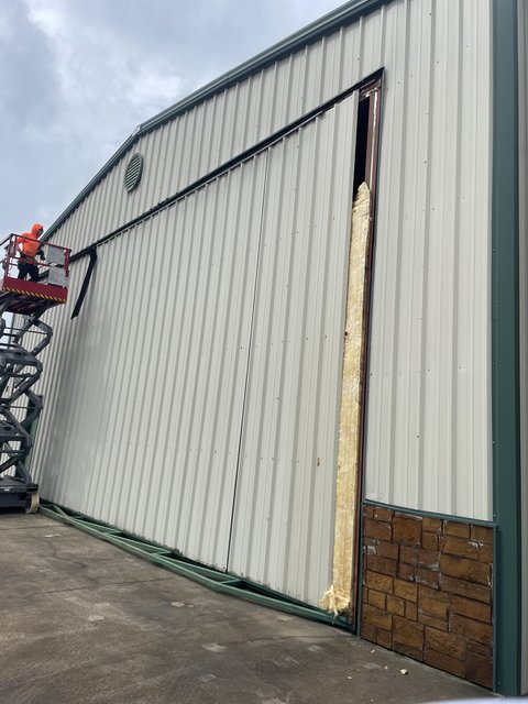

Repair work started today. In this photo, they are removing the weather stripping so that they can access the hinges, The hinges on the end of the door nearest us in the photo are completely broken and are not supporting the door at all. The bottom of the door at this end is resting on the ground instead of being suspended by the hinges.

I wonder if rain/moisture is trapped and collecting on the metal/angles on top of the door/hinges?

How often do you lube the hinges? The doors on our hangar in SZP West (Bifold, cables driven by electric motor) has hinges that are 3/4” rod running through tubes welded to the door. It started making a nasty pop on opening. I thought it was just the tile that a prior owner put under the door. Nope, the hinges and hinge pin were sticking, then popping loose with a loud crack. A neighbor explained that I’d best lube the hinges post haste less I have broken hinges as others in the complex have suffered. Hit them all with some spray white lithium grease and it quieted right down. Makes sense that if the hinge pin rusts to one of the tube, it is likely to put excessive load on the weld and surrounding steel.
