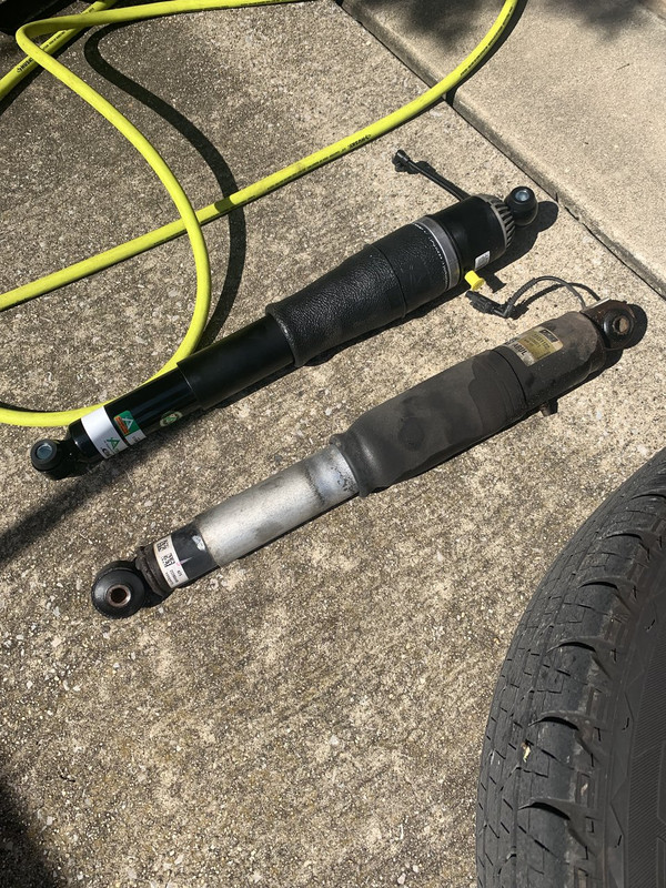

Rear shocks have taken a dump on the rear of the Suburban. Of course it has the magnaride and auto air leveling shocks.
They are about $475 a shock. The Magnaride is fantastic on the Highway but complete and utter crap on regular roads and especially gravel roads.
Most folks seem to swap it out for standard style shocks. One needs to fool the computer into thinking the Magnaride is functioning properly so you don’t get any errors on the dash. You also have to bypass the air compressor and loose the auto level feature.
The rears are a must and must be done now and I don’t really want to loose the air leveling option.
Found a plug and play shock that maintains the air leveling system and bypasses the maganride system.
It’s by a company called Arnott to which I am not familiar but they utilize a Goodyear airbag system and an Eibach shock absorber.
Both of those are solid companies and the unit is made in the United States. Most folks seem to like these on the forum and say they ride far better than factory Magnaride when working.
Hopefully this is true.
I found them on RockAuto for $512 for the pair after tax, shipping, and the usual 5% off Rock Auto Coupon Code.

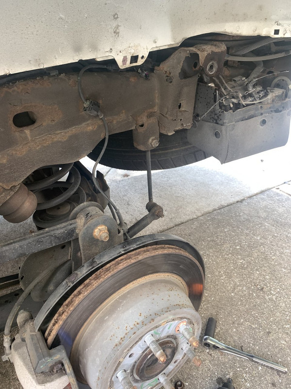

Finally got a chance to install the rear shocks. Install was super easy thankfully. The most time consuming part was removing the fender liner.
Once that was out the top nut was visible. Popped that off undid the airline and the electrical connector at the top and undid the bottom nut.
Shock came right out.
Slid the top in installed the bolt and loosely installed the nut.
Had to slightly jack up the lower control arm to line up the bottom eyelet popped in the bolt jacked the control arm up a bit more to tighten the bolts with weight on them. Plugged in the airline and electrical connector put the wheel well liner back in and did the other side.
Out for a test drive started the truck up and the compressor kicked on for a bit and shut off as it should.
Ride is buttery smooth and much better than factory!! No suspension error lights on the dash!!
