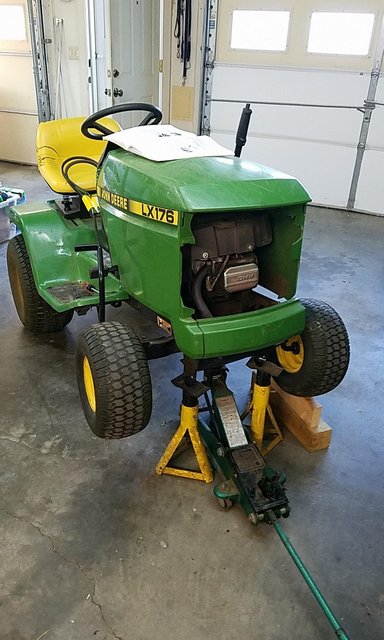

Step one: get the front end off the ground and get the old belt out.
Yes, I know the grille is out too. Razz
Jack stands under the front, steel ramps wedged up under the back [after this pic was taken]. We're stable now.

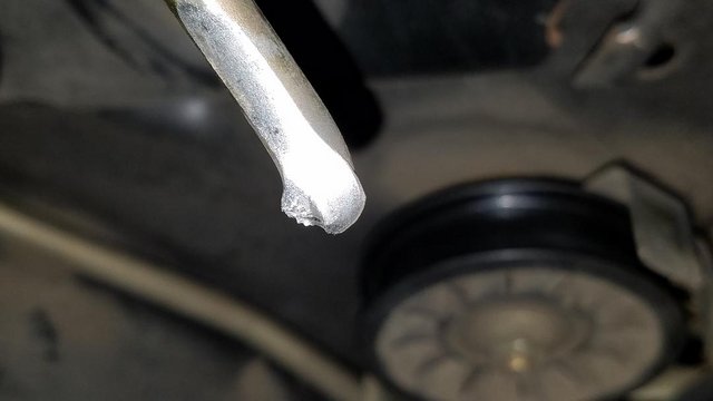

First up, the lever. Is it broken? The end of it looks/feels rough, as if part has been broken off.

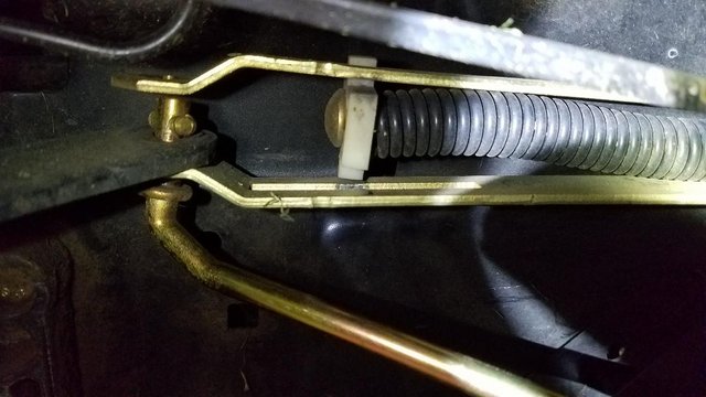

Next, the tensioner. I think the far left bar (top of pic) supposed to be closer to its mate than this.

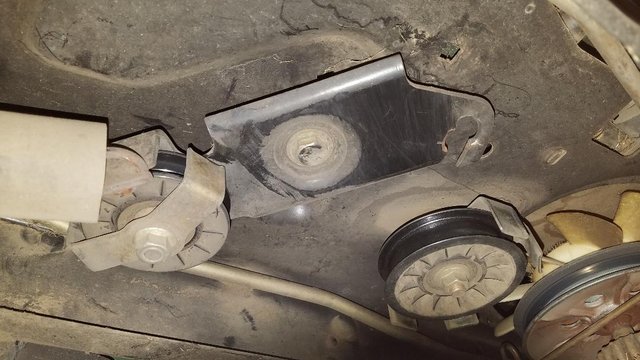

And then there's this plate with the odd-shaped hole in it. It seems to be part of the go/whoa system, but I'm just plain ignorant about it. Does this look damaged or normal?

Yes, the lever #5 is definitely broken.
The plate in Picture #4 appears to be worn but not broken. That's #9 in the diagram. It's what the other end of the spring that tensions the belt attaches to. As long as it pivots smoothly, it should be fine.

Update: I got the little Deere back on Wednesday. The tension lever was all that was broken underneath. Second lesson learned: there's some safety mechanism built in, such that if that lever is out of place the mower won't start. I wasn't aware of that before.
