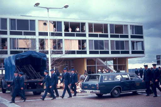

At the Air Force Academy, a famous incident had an F-105 do a flyover - where it 'accidentally' broke the sound barrier (they could never *prove* the pilot did it on purpose).
Now, those familiar with USAFA know there is a LOT of glass in the architecture. Well, thousands of windows were shattered by that fly-over, just from the effect of the boom.
