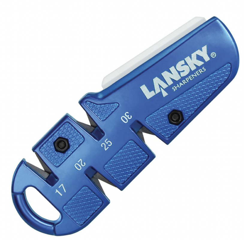

I just keep a few of these Lansky QuadSharps around. They work better than a honing steel for me and are quick and easy.
