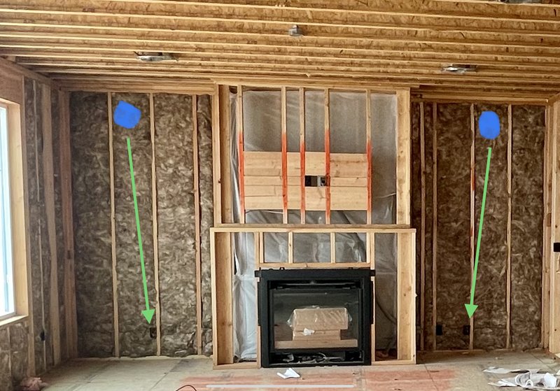

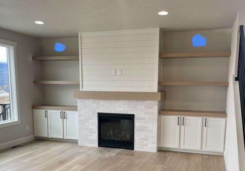

I have a question for the electrical folks on board — I am going to be mounting a a couple wall light fixtures / sconces above some shelves on either side of our living room fireplace wall. We overlooked having this done when doing our original electrical walkthrough with the builder last year so now I’m just gonna take it on.
Initially I was planning on taking the “easy route” and just tapping into power from the pre-exiting outlets down by the floor level and powering these lights separately … I’d use smart bulbs that are Wi-Fi enabled so I could easily turn them on / off, set dimming, and put a schedule on them (I understand that power to them would always be “on”, I’d just use the “smart” bulbs to control when they’re actually illuminated). This would be a relatively easy install and would work for what we need.
Buttt … now I’m wondering if I should take this next level and connect these sconces to each other and add a switch that would be places on one of the side walls. If I were to go this route it would certainly be more finished / professional. With this approach, I’m curious to hear what your take would be on how to do it (as in, the wiring setup / scheme and any other input or ideas). I can think of a couple different ways to do it but I’m just curious as to what others would say … I’m looking to keep it minimally invasive, obviously.

I think the space above is literally another story because those look like floor joists running across the ceiling.
As a non-electrician looking at the pictures, I know exactly what I would do: I'd live with out the extra lights.
I'm sure there's code that says wires run vertically inside a wall have to be attached to the studs at certain points. I'm sure there's one about how to attach the light fixtures in the middle of the two studs and getting the wire to the box there. That's just not a project I'd do myself and looks like $500-$1,000 to pay an electrician and drywall guy.

Lights above the solid shelves? What will the lighting do other than illuminate the small area? Put some temporary battery lights in there to see if you will be getting the desired results.
It looks like you have a ceiling fan wired for but not installed? If so, they are usually wired with 3 wire so you could use one of the switch legs in the fan box for sconces and one for a ceiling fan that is either pull chain controlled or remote controlled that way you maintain control of light/fan individually still, or install fan without light. This would save a lot of drywall repairs.
Option two even less drywall repairs, add switch above left hand outlet, wire to sconce directly above new switch, then to second sconce. This puts switch in an inconvenient spot and may be an eye sore to some, but if the intention is to use WiFi bulbs the location doesn't matter.
With the TV above the fireplace , I don't think you are going to like the sconces in your line of sight . Like somebody suggested , put some temporary lighting there to see how it looks .

I have to agree that sconces above shelves will not only cast weird shadows but they won’t look right. I’d skip the hassle.

To answer the question, above and below are finished areas (upstairs and basement).

The sconces will make the built-in look like the built-in was added after the lights were hung as an afterthought.
I think you would be better off adding recessed "eyeball" style can lights in the ceiling in front of the shelves and tie them into the existing cans in the ceiling.

Why not just low-voltage LED strip lighting like something you would see under a kitchen cabinet??
The new stuff is very configurable, from brightness to color.

Surprised that you don’t have fire breaks in the wall stud cells. This would make it much easier to run wires, though, so good fortune there. I’m seeing LED strips under the two shelves, powered from the wall, just under each shelf, with small wires running through the wall from the outlets in the lower cabinets. I would put a small pushbutton switch fixture on each run, perhaps horizontally at the lower cabinet shelf. I would replace the cans in the ceiling with eyeball cans that might be directed a bit towards the contents on the top shelves. With LED lights, I would ensure they all were of the same color temperature.

your only going to light the top shelf my 2 cents
replace existing cans with dule direction cans

Before you do anything else, mock those up in position & use a flashlight or something to give finished appearance. Turn other lights off/on. Have the boss inspect it.
I think the idea will be different than the reality.
Posts: 3458 | Location: IN | Registered: January 12, 2007Reply With QuoteReport This Post
I don't think you are going to be happy with the end result. You'd be better off with small recess above the shelves and puck lights/LED strips under them.
