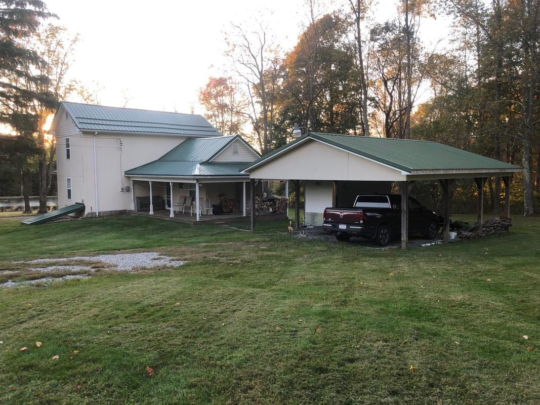

There's one at my guest house. The previous owner was a builder and erected it using trusses that he'd removed when rebuilding a home that had fire damage. The insurance company told him to replace them all even the ones that weren't burnt.
So it's built as you would a pole building with the treated posts buried maybe 2 1/2 or 3' deep. He and his two helpers took about a day setting the posts and a second day setting the trusses and installing the roof, so something like this wouldn't cost much to build.
I apologize for the clutter, I'm temporarily using it for my truck and trailer along with some other stuff. It's about 24' wide x 26' deep plus 1' overhang.

30' is a deep garage with room for work bench and riding mower in front. A typical one is now 24' x 24' while a small 2-car garage is 20' x 20'. It's hard to see in my picture but there's a good 8-9' in front of my Ridgeline.
