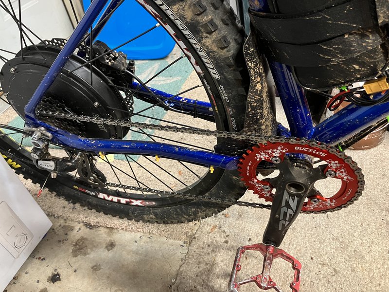

42T chain ring installed! I still need to install the 9 speed cassette which I will do when I tear it apart to convert the tire to tubeless to match the front.
The 42T narrow wide chain ring alone should add a bit of top end speed over the 38T narrow wide chain ring it replaced.
