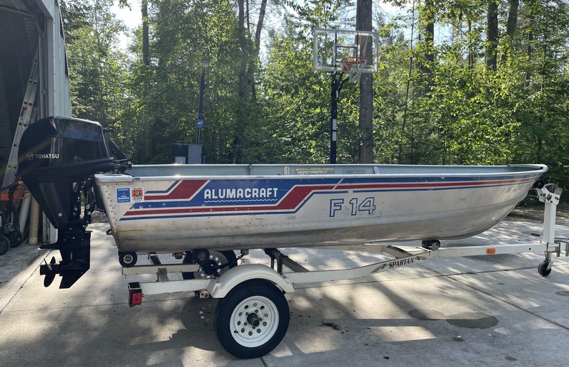

Son and I put a couple more hours on it today. With less chop and no rolling swells we hit 28mph at WOT. If that’s all lowering the motor so it rested on the top of the transom did, I’d call it a day. Unfortunately, the boat felt sluggish at all speeds, didn’t pop up on plane as quickly, and didn’t plane until 15mph. Before, it planed at 13mph. We also tried one trim hole on each side of the hole we were using and both dropped 2mph and RPM.
Speaking of RPM, the motor does have spark plug wires. I’m going to blame my 101 fever for mistaking the wiring harness and connectors of the fuel injectors for stick coils. Looked at it this morning and there’s obviously a fuel rail, so I looked at the other side of the motor and look at that, spark plug wires going from neat little individual coils right to the spark plugs! Tach works much better now.
I’m still amazed how quiet these 4-strokes are. Pull starting a 500cc motor is fun until about the third pull. You have to have a quick, sharp pull to get it going, except about every third pull has the engine compression working against you, so your quick, sharp pull rips the T-handle out of your hand and you add just little more damage to your 56 year rotator cuff.

28 MPH is pretty quick in a 14' aluminum boat and on plane at 15 MPH is respectable with two souls on board. Get some swivel seats in there and you've got a great little 2 man fishing boat that's plenty powered.
