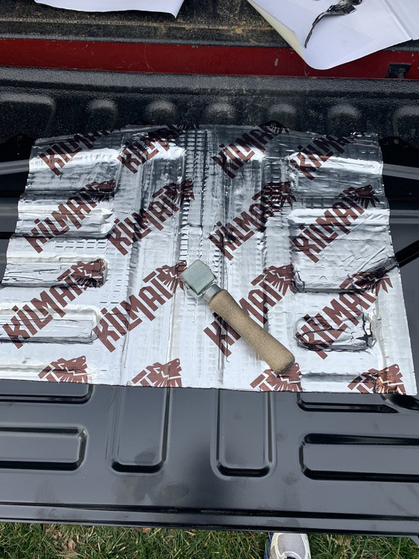

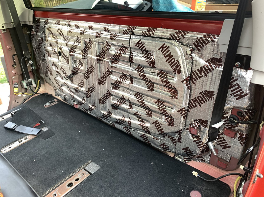

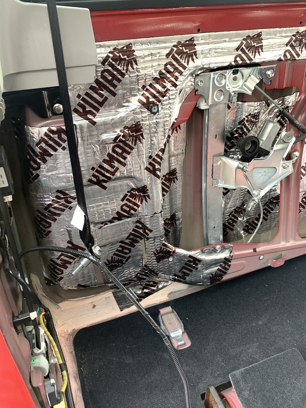

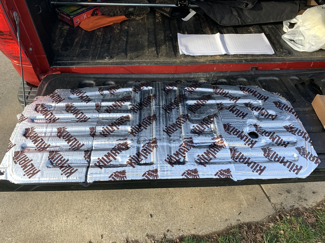

So I got to it a little today. I got the back wall and panel. Pulled the seats 8 bolts was easy. Of course had 3 car seats to pull first. Absolute worst thing about having kids is car seats. While they were out and the seat cover off I cleaned and conditioned the leather as well. Pulled the subwoofer and the foam pad between the seat and the wall. Some folks I have seen just do a layer of material right over the panel and don’t even remove it.
I opted to remove the panel for 2 reasons. 1st being so I could also put material on the inside of the back wall and 2nd so in case my window regulator ever goes bad I don’t have to cut the panel out. Not a bad job just very time consuming especially working the back wall and working around the window tracks and braces. If you removed all that it would be much easier but I was not getting into that. I think it turned out pretty well. Just doing the unscientific tap test there is a huge difference. This took me about 4 hours. I will be doing the backseat floor and putting it back together tomorrow.
I did buy an Alpine Subwoofer to just swap for the factory paper JBL but it t was a bit too deep so need to add a spacer ring. Yippy get to take the seats out again next week or so.

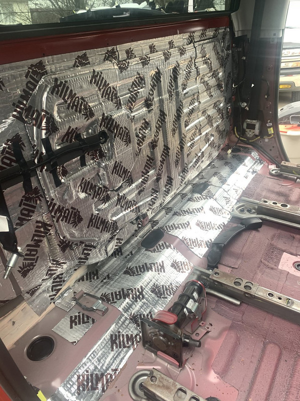

Did the floor today. There actually is not really a ton to do. Toyota has some already on the big pan section and doing the unscientific tap test works pretty well.
Now that it is all back together it absolutely makes a huge difference. I can’t wait to get the doors done now. One can feel the bass at a much lower volume level and it is much more crisp and solid. Now my front door panels rattle a bit from the added bass.
Listening to Black Cadillac by Hollywood Undead that has some very solid long lows one can now see the door panels vibrate outside of the car. This was not visible prior so looking forward to getting in there and adding the Killmat to them. I am about $50 in material for the back and floor. Likely about the same for the doors. I presume I’ll end up doing the roof at some point.
